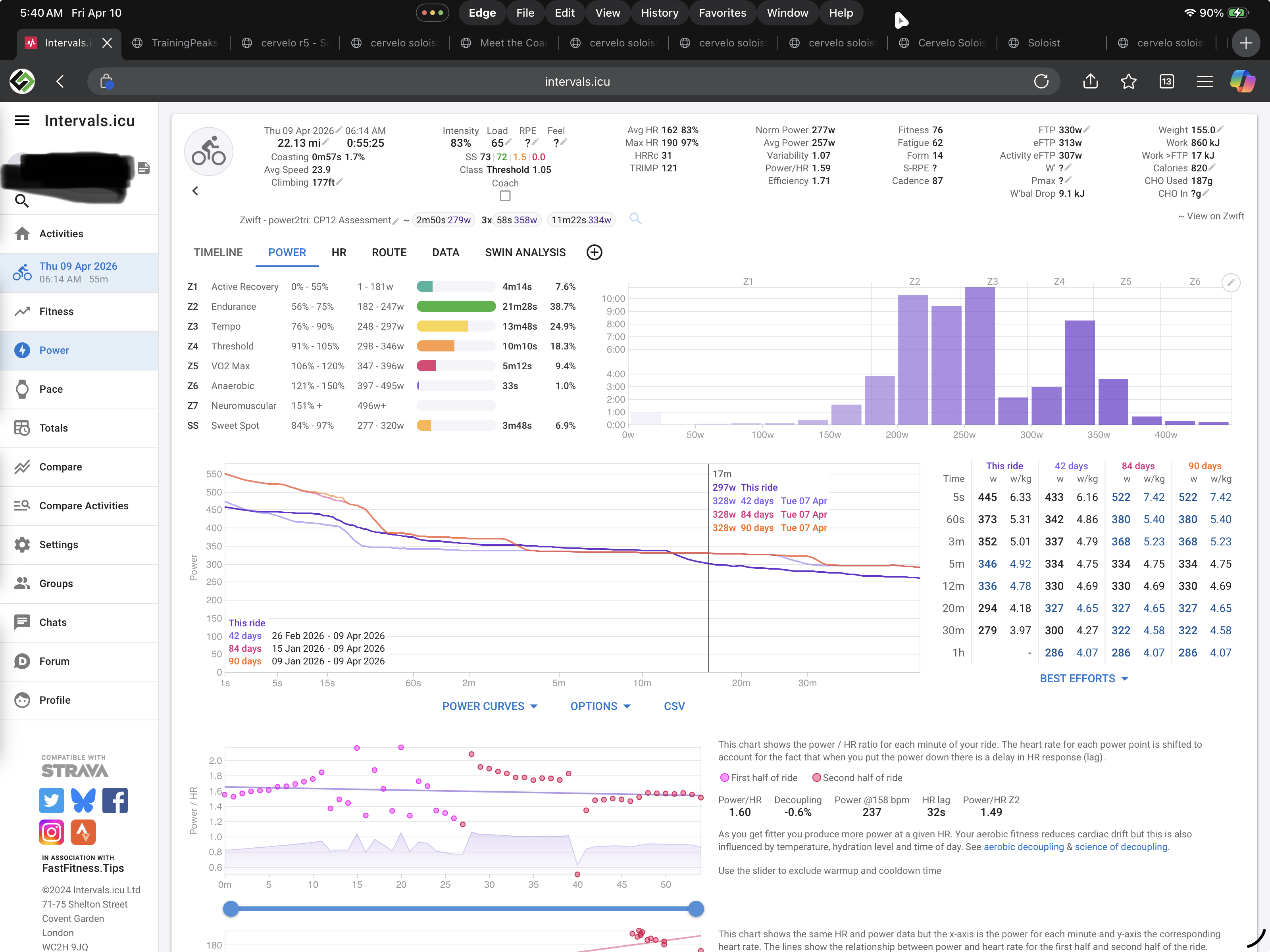

@david TTE not showing for me on my power tab
Hmm. Can you please post a screenshot. I just had a look at your power tab and TTE was there.
Yes sorry david i found it later.still getting used to all this
Hi @david and others… came across this thread when looking for a way to track TTE progression as at 21mins its something I want to look to improve. Cannot currently see TTE as a selection in custom charts tab so assuming this suggestion never made it, is it something that can be looked at again please?
There is TTE on the /power page on the right hand side. That tracks how long you have managed to ride at your FTP for.
This is great, but as above posts it would be fantastic to be able to plot this on the /fitness graphs so you can trend over time :slight_smile:
