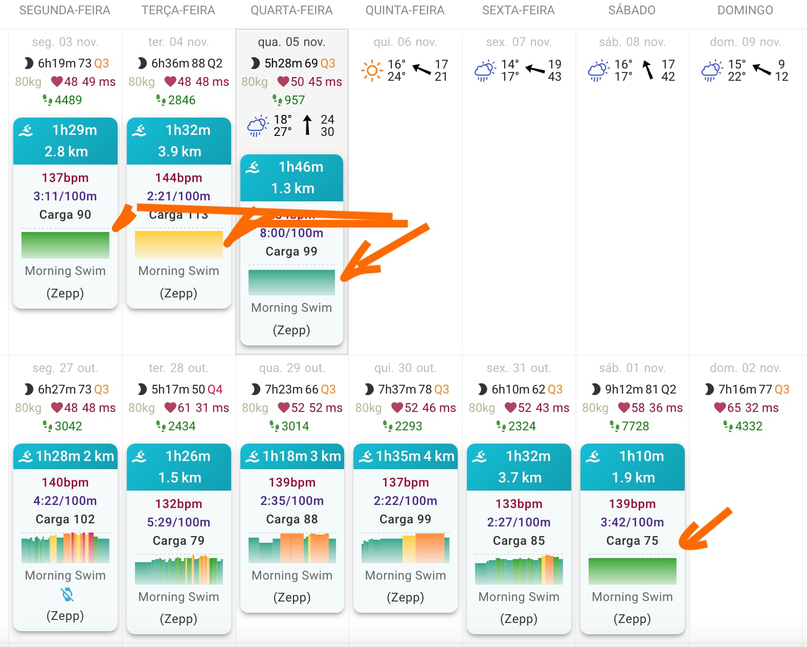

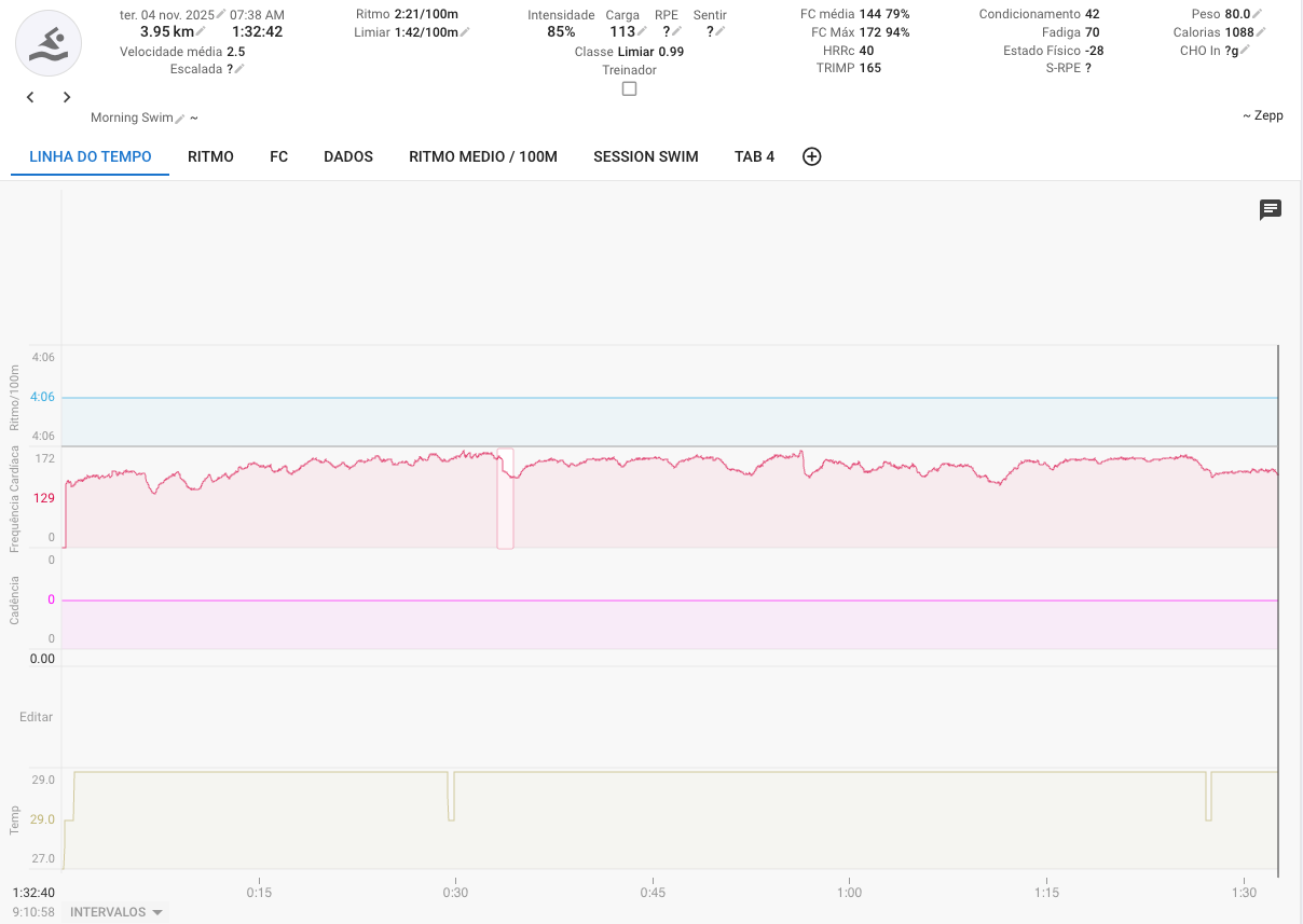

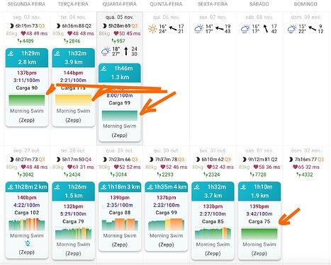

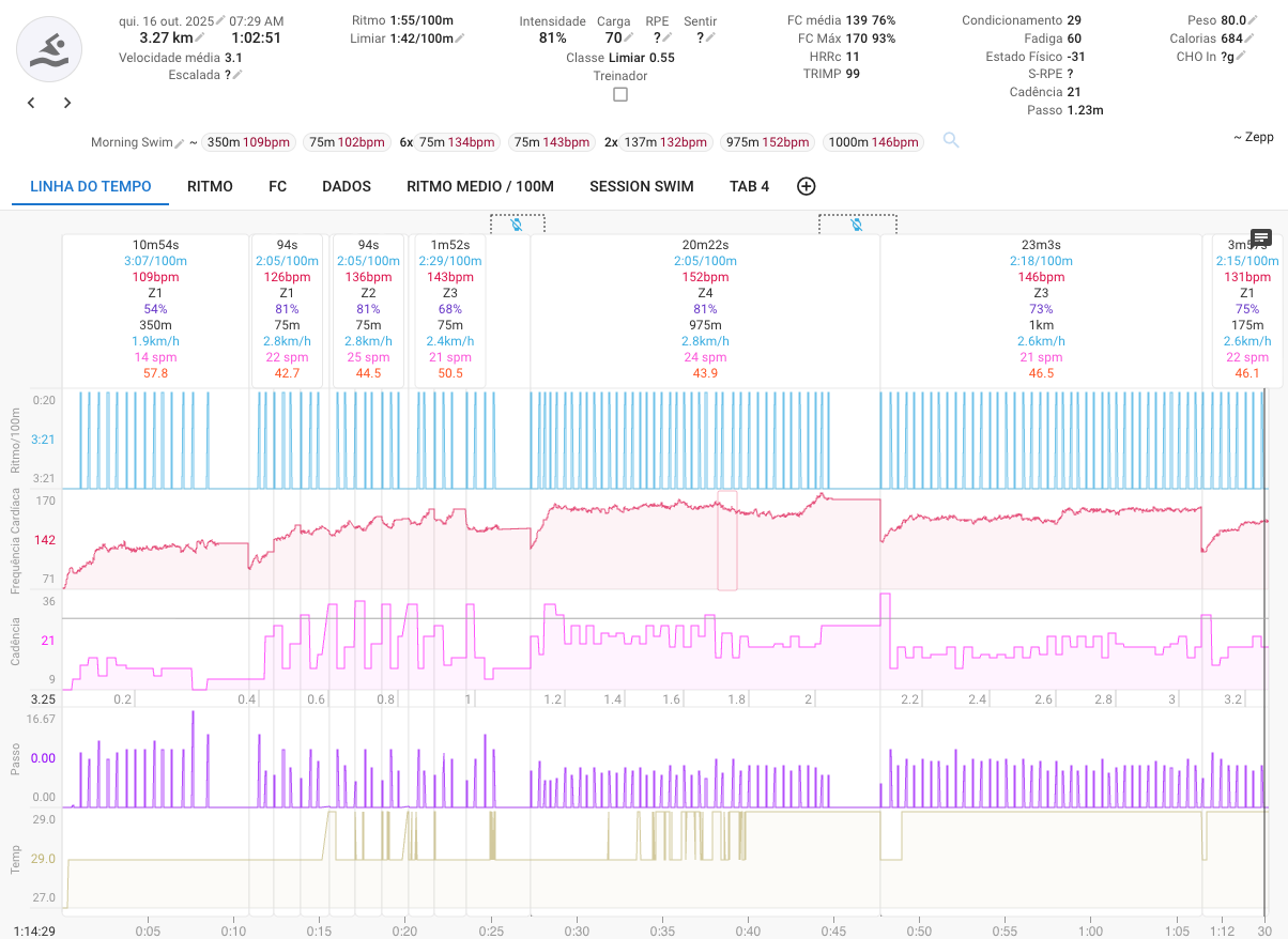

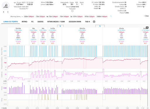

I practice swimming and I have a T-Rex 3.
I’ve been syncing Zepp with Intervals for about a month and everything was working fine.
About 4 days ago, the pace and cadence data stopped syncing. Only heart rate and temperature data are being synced.
The lap intervals are still working, but since pace and cadence data are no longer being received, the intervals don’t appear. If I manually correct the pace and cadence data, the intervals reappear, however, obviously, the pace and cadence are wrong.
Does anyone know if it’s a bug, or some setting that needs to be adjusted in the synchronization with Zepp?
Workout before and after 11/01
After 11/01
Before 11/01

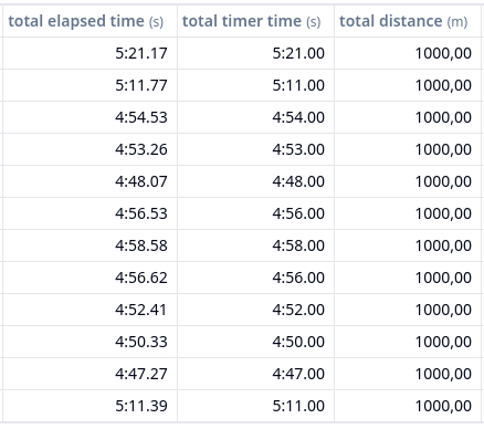

Hi.
I don’t understand why, if intervals obtains this FIT file through the Zepp API,
it displays this
(even if I use “Reprocess File” → “Use Laps instead of detecting intervals”)
I have Active 2, just sync it with Intervals for the first time. I confirm, there is not interval data for swimming. In Data tab, all falls under one ‘Recovery’ record. I’ve checked the ‘.fit’ file, it has the Lab data. Reanalyzing the file does not help.
The problem persists. The cadence and pace data are not synchronizing, which is why the intervals are not being created.
