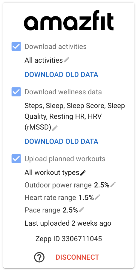

We have been working closely with the Zepp team to support Amazfit brand watches and other devices. The first version of this is live. Look for the Amazfit box in /settings:
You can download completed activities (rides, runs etc. with support for power meters) and wellness data (steps, sleep, resting HR). HRV and readiness will be available in future.
Just tick one of the checkboxes to start then authorisation process.
Activities are delivered via webhooks and should show up within seconds of upload. A poll for activities in the last 28 days is done the first time you visit Intervals.icu each day. You can fetch more using the “Download Old Data” button.
Wellness data is polled when you visit Intervals.icu for the first time on a day and several times a day after that.

You can upload planned workouts to the T-Rex 3 Pro. Intervals.icu will upload the next week of planned workouts whenever you make changes and approximately 3 times a day to pickup new workouts.

just got my Amazfit band yesterday and after one night’s sleep I connected to intervals, but I cannot see any data (RHR, Sleep). Any ideas on how to troubleshoot?
I think you likely have to open the Zepp app on your phone to sync first.
Yep did that, then I disconnected and connected again and clicked on Download old data but still no luck.
The Zepp AI isn’t returning anything from the sleep endpoint for your access token. I will ask them about it.
Sorry but I have to ask, you only have one Zepp account right?
