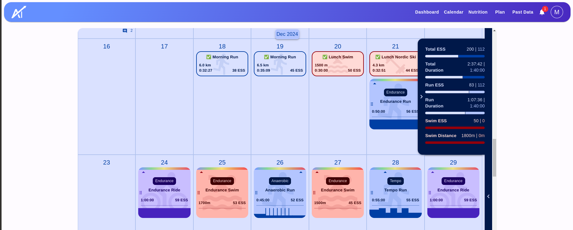

For the weekly load you can expand the sidebar on the right of the calendar page
For the load ramping: actually how you describe it is not how we have designed/imagined it. It should do exactly what you where hoping for and slowly increase your volume and your longest activity duration depending on your last 6 weeks of data in the system. Could you please send me the email address you used to create your AI Endurance account to [email protected]? I really want to have a closer look at your account to see if there’s a bug or something is misconfigured for your case.

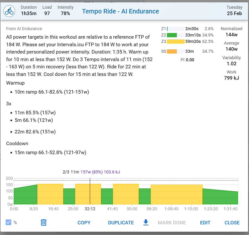

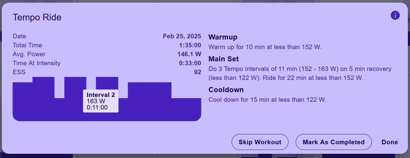

Hi @Markus_Rummel_AIE
I see differences in target power between AEI and the corresponding workout in intervals.icu
Generated a new plan in AIE.
Tomorrows ride shows a target of 163W
That same workout in intervals.icu show a target of 157W.
I have set the ftp in intervals.icu to 184.
AEI intervals is between 152 and 163. 157 is just in the middle !
Thanks. That makes sense.
Yes this. Seems Intervals.icu picks the middle value when the instructions are a range
That is correct. Ranges target power to be sent to trainers in erg mode is a specific number.
Trainers can’t deal with a range target.

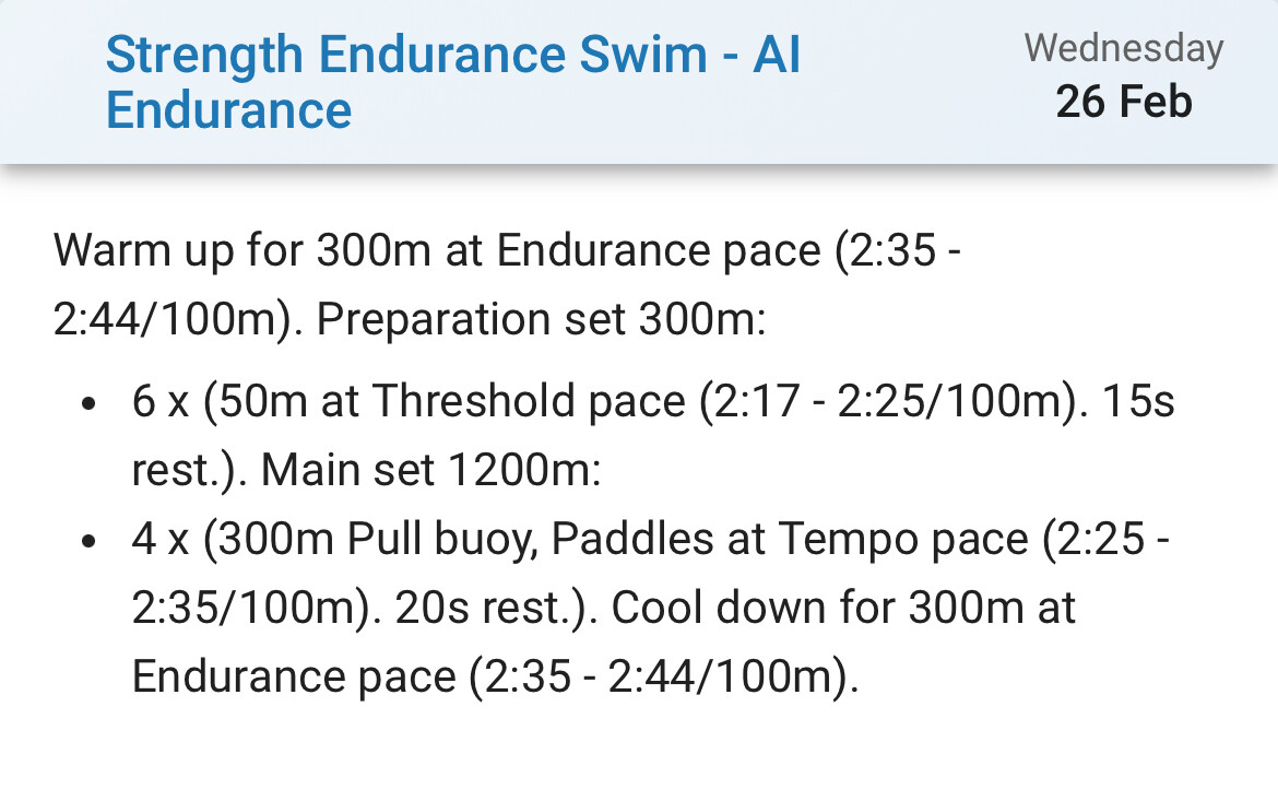

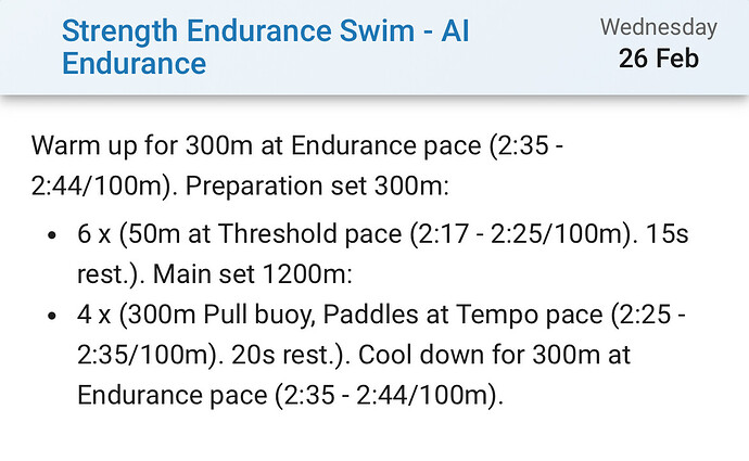

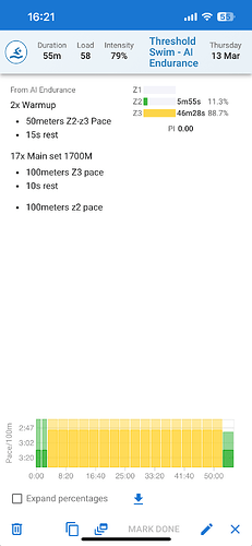

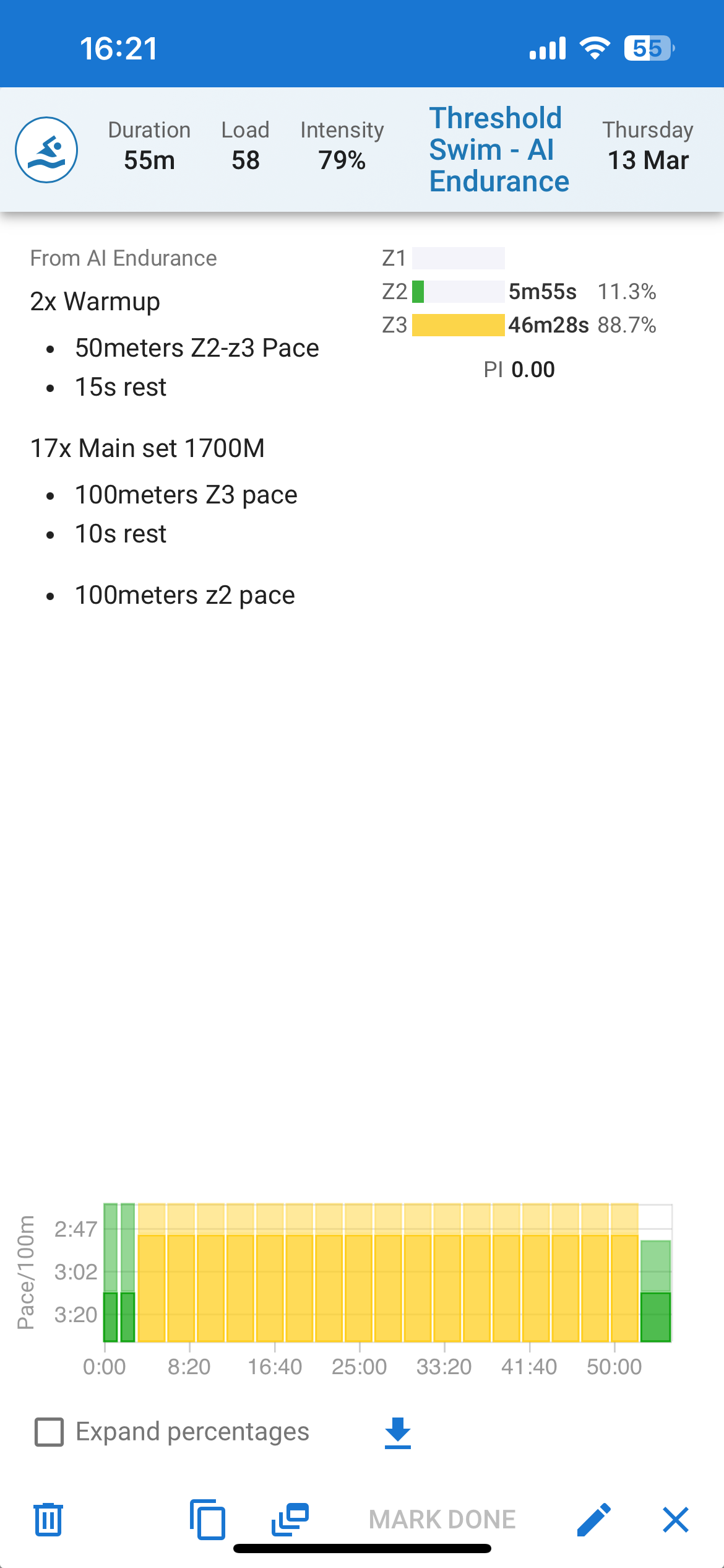

Hi there, I’ve been an active subscriber for the last few months.
My main complaint is structure swimming workout not properly parsing in interval.icu: the structured workout syntax is way off and I have to manually edit to make it works.
Currently the workout are copied in this format (not recognized by interval as a structured workout!):
Hm that is odd formatting indeed. And it’s formatted correctly in AIE? Just checked and we are exporting the same way to Intervals as we would display the description in our app.
If I remember correctly, when we did the integration a few months ago Intervals did not have the option to export a swim workout in a structured way, just the workout text. Is that still the case @david ?
Hi, for your reference, I manually modify next week workout in intervals:
When I modify it, I noticed that the AiEndurance workout was marked as Category = “Note” (instead of “Workout”), and the formatting is way off.
The same workout transferred from AI Endurance to TP is properly formatted and work correclty on my Suunto.
Thanks! It’s true we are currently exporting swims as note. Will look into if structured export works
