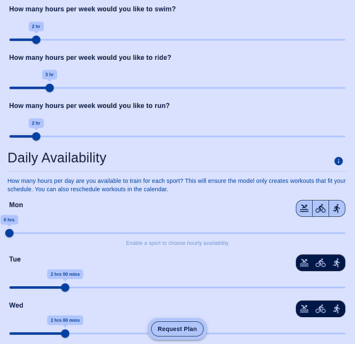

Two questions:
  • I assume that AI Endurance calculates the different zones (power, heart rate, pace). Is this also exported to Intervals.icu?
  • My schedule is very variable due to my work as an emergency physician. Some weeks, I have four free days, and other weeks only two. Is it possible to input this into AI Endurance so the AI adapts?

  2. we do availability per week day (see screenshot) but you can also adapt your plan via drag and drop, skipping workouts or if you simply don’t do the workouts we might propose modifications depending on where you’re at in your plan/how crucial the workout was
