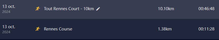

When analyzing the calendar, it did not record my 10KM race on October 13th, there is only the warm-up :
Capture d'écran 2024-12-04 084031
On Coros, my race is present:

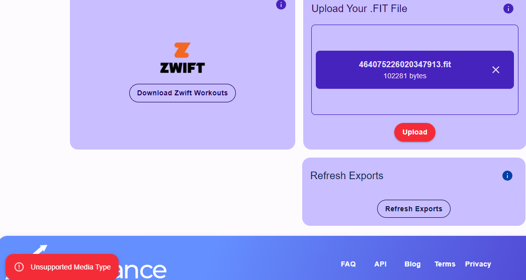

When I try to manually upload the Coros .FIT file of my 10K, I get this error :

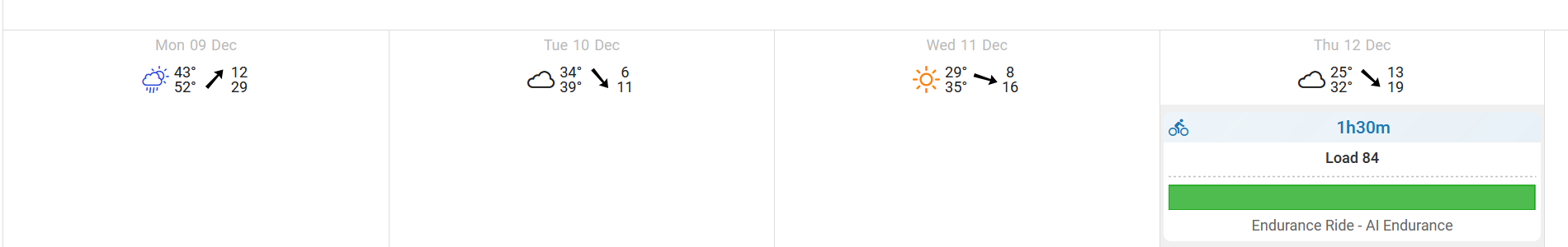

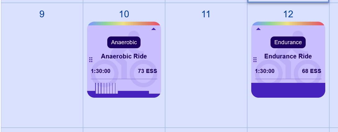

I continue to see issues with planned workouts not being sent from AIE to intervals.
Here’s a current example:
AIE shows a workout for next Tuesday and Thursday:
intervals only shows the Thursday ride, but omits the Tuesday ride:
I changed the update of the export slightly so hopefully should b fixed now. Let me know if the issue persists though please.

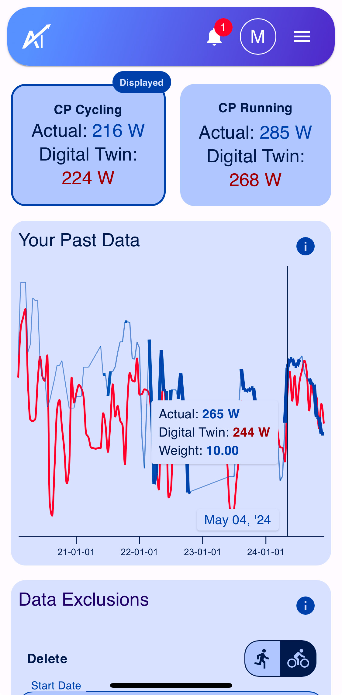

You don’t have to it just increases the weight (think attention the model pays to a particular datapoint) if you label as a test and also knows how to estimate thresholds (e.g. ramp vs 20 min test). We’ll also add hopefully next week that you can tick a box to label an activity as a race which also increases the weight.
As of this week you can actually see the weight of each datapoint in the past data chart in the tooltip and via the line thickness, see attached screenshot

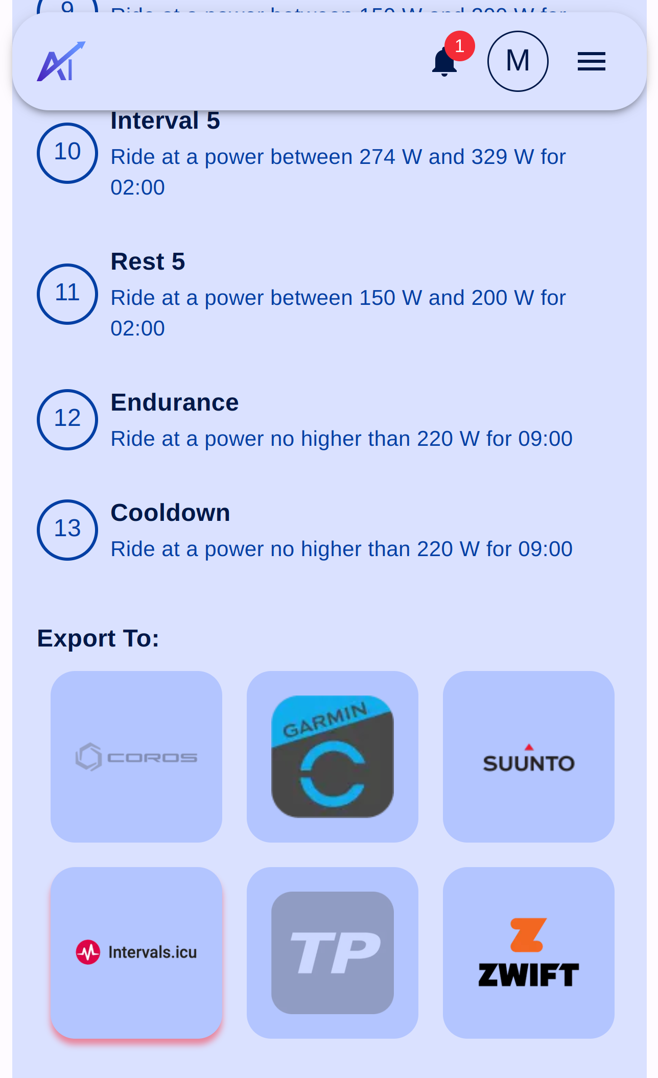

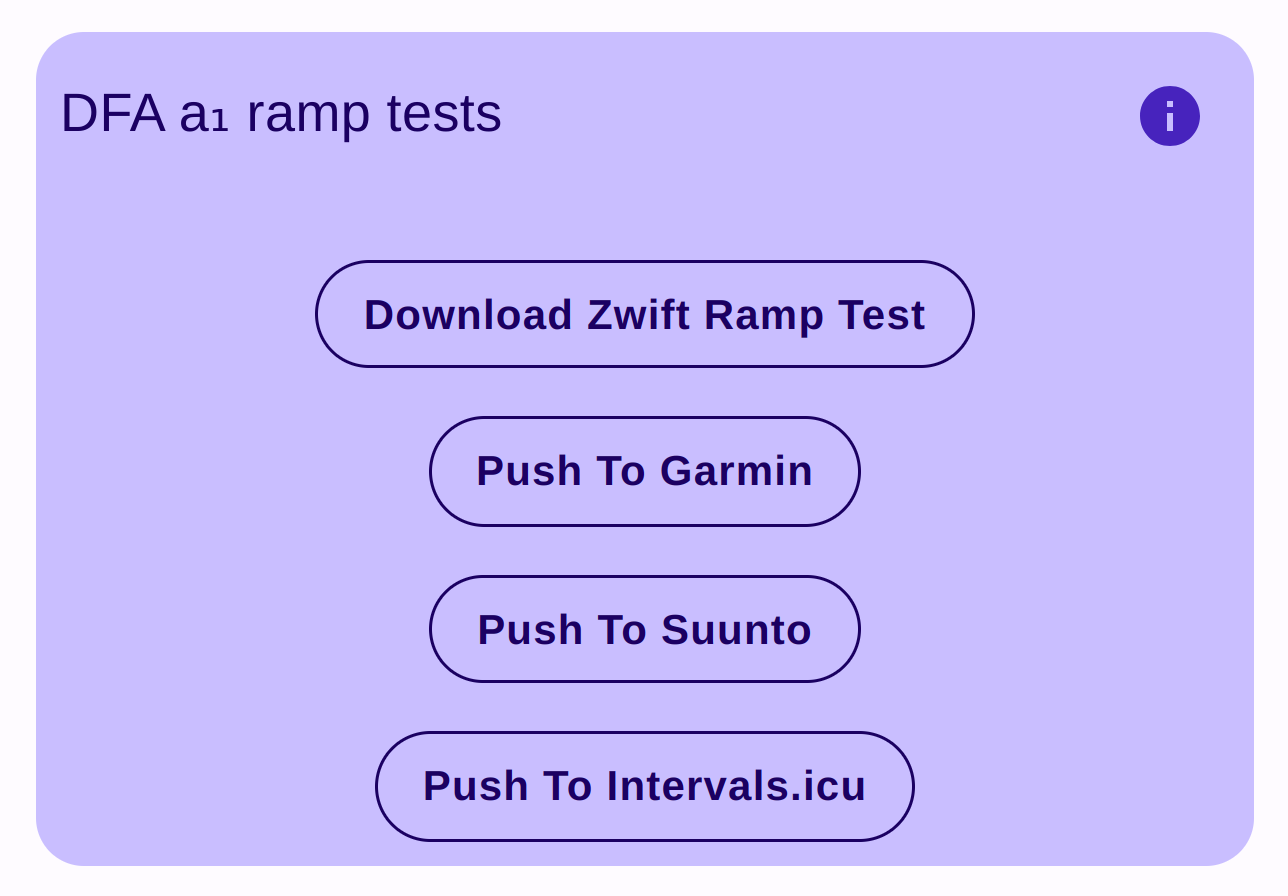

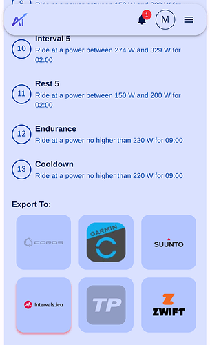

Update: You can now
  1. Export DFA ramp tests to Intervals.icu (previously Garmin, Suunto, Zwift file download) from third-party apps page
  1. One-off workouts created via the workout generator can now be exported to Intervals.icu
