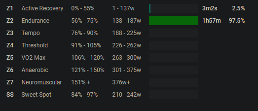

Yes, I am using HR to register it, and also use RPE. I know the feeling from running. I will do a ramp test soon, but just wanted to get the legs and body used to the bike again first. Is starting with 2x15 min sweet spot and increase it to 2x20 ok? What kind of threshhold should I do? I have probably 2 months before the outdoor season start, where I will increase the zone 2 duration a lot more. I get a little numb from the saddle so that’s why I am at 1.5 hours each now. Are you saying my fitness is a little low? That can be because I inputted 250w ftp randomly. I am at the higher end of the zone 2 when riding. That’s like 155w average. What should be the target for the longer zone 2 ride? I will increase that gradually of course.

I am kind of interested in how I can improve that fitness score though. Does it mean I overestimated my FTP guesstimate? I do use a power meter. I do the REP test and conversation test which puts me at 155avg watt. I would estimate that is a little in the higher zone of zone2. What classifies as a long zone 2 ride though? The two hours today at 155avg felt good. Could it be because I have had some breaks and changed from elliptical to cycling in between? It is a 42d avg as you say.

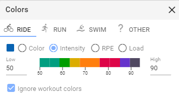

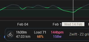

A lot of my activites has the orange color when it comes to load even though the graph is green. I gather this is probably because my FTP is set wrong, but does the load indicate transition ant the graph green zone/optimal?
That´s compliance, and shows how well you did compared to the planned workout.
@Jcmiii is right. It’s not compliance, it’s IF = Intensity factor and takes the color of the zone that complies with that intensity. I was also confused by the different screen layout.
HR and Power take the standard metric color.
That is an Intensity score. My screen doesn’t look like yours. You are using a phone? On my iPad if I click on that number, I get an explanation. I’ve clicked on about everything in the display. :joy:. Some in addition to an explanation give links for more information. Great app!
Or maybe not! I just saw new post beat me to it.
Agree, the 68% is the intensity of the activity.
The desktop shows in colour, as well as on the phone.
Oh, so it’s orange in terms of intensity, while a green would be easier. Got it!
Check if your activities linked to intensity?
Activities page, Options, Colours
Yes, modified my post above while your replies were coming in.
Yeah, all default here :+1:
