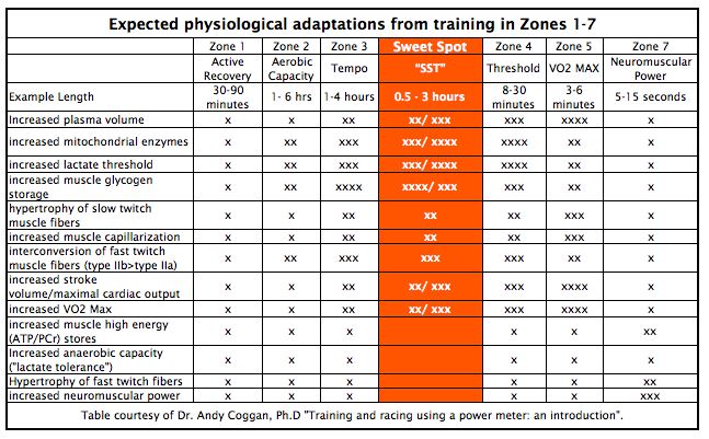

Z2 is nothing special, no additional benefits other than allowing you to accumulate volume whilst keeping you fresher for your hard days, so you can actually do them hard, and hard for longer.
coggan

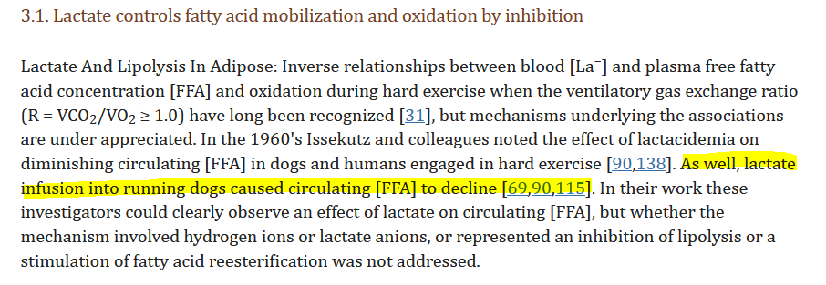

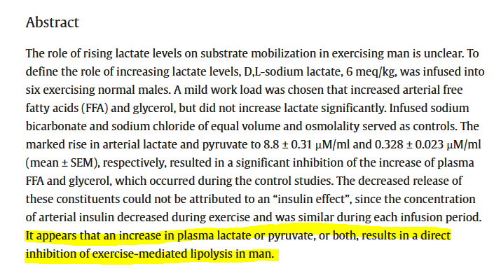

Can you provide a source for this? And can you quantify how long and into what zone this apparently occurs? For example, if I ride for a few minutes at threshold, you’re saying it’ll take me 30 minutes to recover?
My understanding as a dumb engineer is that all energy systems are “on” and in flux, and your body will use the easiest energy available to produce power for the task.
I’m far from being an expert in the field, but from what I understand, lactate serve also as a signal molecule, and over a certain level it inhibits the fatty acid burning in the mitochondria, and this inhibition lasts around 30 mins.
(this is what I got from some reading and mostly from listening to Iñigo San Millan and George Brooks. I’m sure ppl will correct my mistakes)

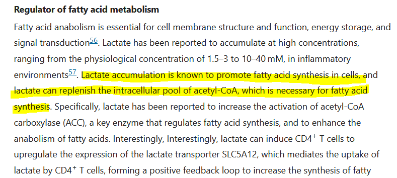

Am I understanding this incorrectly?
https://www.nature.com/articles/s41392-022-01151-3
And of course there’s this…
https://www.sciencedirect.com/science/article/abs/pii/002604957490081X
And for exercising dogs…the highlighted statement seems counterintuitive…introducing lactate reduce FFA. Does that mean FFA were produced less…or were FFA’s used more, resulting in a lower FFA count?

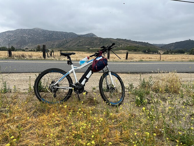

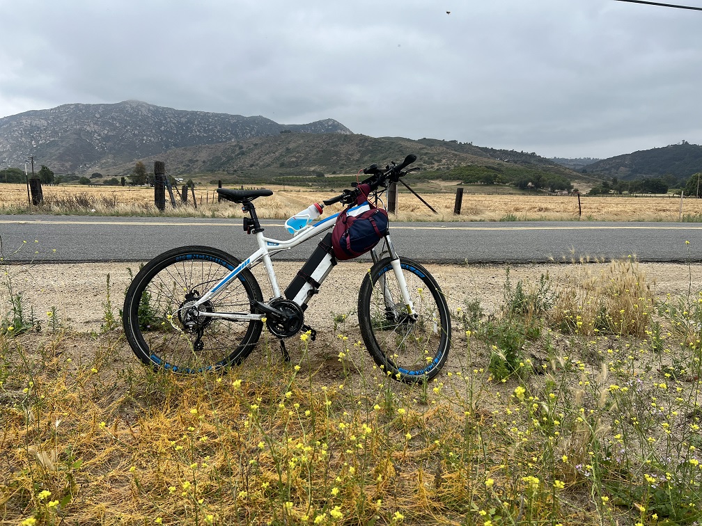

I don’t know much about road bikes & am new to cycling but I used to use an eBike to do my Zone 2 work in a forest trail/fire road environment on a cheap Decathlon emtb. Depending on how wet it got on a regular bike I used to have to go into a sprint just to make it over a hill, the ebike obviously fixed that.
Now I got a 52t easy gear on my acoustic mtb on a 1x11 drive train (Shimano CUES), the same hills I used to have to sprint up are now comfortably within my aerobic zone & I no longer need an ebike. I’ve found it to be a revelation in training before AeT. The descents are another situation though, the terrain is sometimes too rough to not be on the breaks with my bike skills. The bike skills are coming along but it’s taking longer than my endurance.
That’s how I solved my hilly problems. And for me, I can ride 60 miles in a 3 hour endurance ride and see a lot more scenery. And it’s fun!
I put my Assioma’s on the bike and get power just like my road bike.
