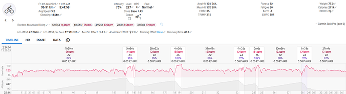

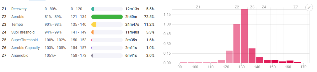

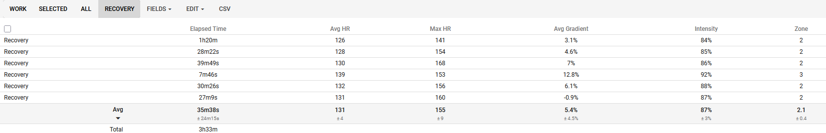

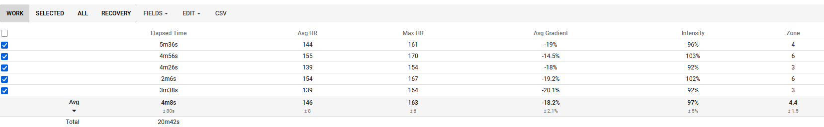

For a bit more context I’ll attach some stats of what I would call a “typical zone 2 mtb ride”.
That’s a 3h42 ride, with ~78% of time spent in Z1/Z2 and ~22% spent above.
Looks like 5 downhill trails ranging from 2 minutes up to 5 and a half minutes, totaling ~21 minutes of 222 minutes total (10.6%). I’m not immediately sure which side of the “it depends” line that sits but it is certainly more work than a single 3 minute interval in a long road ride.
I would be fine with that. As you say, you are time limited, not recovery limited…
