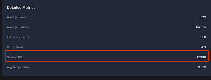

I think there’s some inconsistency in the RPE in the workouts imported from intervals.icu.
iScreen Shoter - Google Chrome - 251223124346
Nice find - that does look a bit odd. :slight_smile:
The biggest problem, in my view, is negatively influencing AI.
“That was a high-intensity session, hitting an IF of 0.766, which shows excellent work capacity! However, the workout was highly inefficient due to major power fluctuations (VI 1.25), which likely caused your poor subjective feel of 3/10. Moving forward, we need to prioritize smoothing out your power delivery to maximize the effectiveness of this hard work.”
This variation is an over-under workout from TrainerRoad, and the RPE was 7.

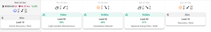

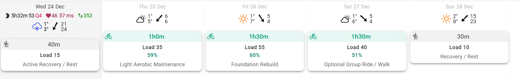

Based on this I asked it to list my planned events, then create an action plan for the week then asked it to add to calendar ahead and it did add these correctly.
Date Session Type Duration Load (TSS)
Dec 24 :person_in_lotus_position: Active Recovery / Rest Walk / Spin 40 min 15
Dec 25 :person_biking: Light Aerobic Maintenance Ride 60 min 35
Dec 26 :gear: Foundation Rebuild Ride 90 min 55
Dec 27 :busts_in_silhouette: Optional Group Ride / Walk Ride 90 min 40
Dec 28 :herb: Recovery / Rest Walk / Spin 30 min 10
Dec 29 :cyclone: Planned: Recovery Spin Ride 60 min 35
It created in intervals:

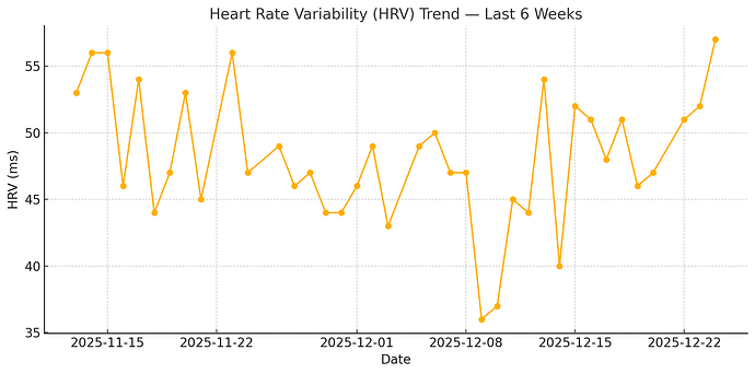

Hi Olirip
I may have fixed it for you. I’m now agnostic on (wellness) HRV source:
Vendor / Platform Detected Columns or Keys HRV Handling Notes
Garmin hrv, hrv_mean, hrvSDNN, restingHR, sleepScore, etc. :white_check_mark: Direct numeric HRV (ms) Native Intervals.icu support; no conversion needed
Whoop recovery_score, whoop_recovery :counterclockwise_arrows_button: Converts 0–100 recovery score → HRV ms (×1.2) Converts recovery % scale into approximate ms
Oura Ring oura_hrv, oura_rmssd, recovery_index :white_check_mark: Direct numeric HRV (ms) Handles both raw HRV and RMSSD fields
Apple Health / Watch apple_hrv, daily_hrv :white_check_mark: Direct numeric HRV (ms) Detected alongside Oura/Fitbit class
Fitbit fitbit_hrv, fitbit_rmssd, recovery_index :white_check_mark: Direct numeric HRV (ms) Merged with Apple/Oura under oura/apple/fitbit source
Polar polar_hrv, polar_rmssd, recovery_status :white_check_mark: Direct numeric HRV (ms) Identified via Polar-specific fields
Coros coros_hrv, recovery_level :white_check_mark: Direct numeric HRV (ms) Detected through REST API if present
Suunto suunto_hrv, recovery_index :white_check_mark: Direct numeric HRV (ms) Optional support, treated as generic numeric
Generic / Unknown Any column containing: hrv, rmssd, recovery, daily_hrv, hrv_status, etc. :gear: Fallback to numeric coercion Used when vendor can’t be inferred
Metric Latest 7d Trend Interpretation
HRV (ms) 57 :down_right_arrow: -1.6 Slight downward trend (fatigue easing)
Resting HR 46 bpm :white_check_mark: Normal Consistent with baseline
TSB / Form +18.3 :green_circle: Fresh Ready for aerobic build
I dont have a whoop so cannot test it :slight_smile:

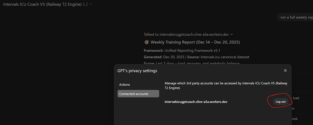

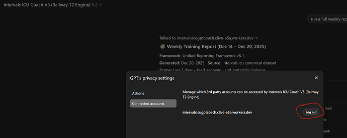

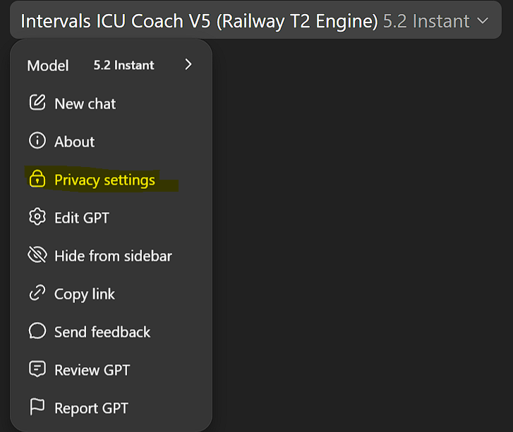

open the ChatGPT app and go here. Can be better on the web as sometime the app miss behaves.
and login:
I couldn’t find this logout option. Could you tell me the detailed steps? Thank you

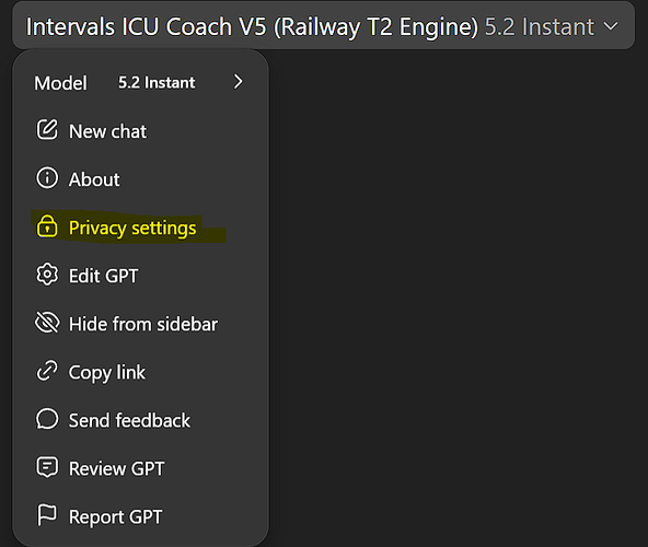

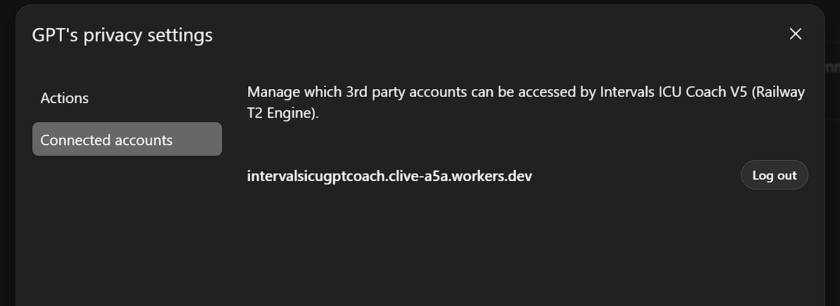

  1. open the app ChatGPT - Intervals ICU Coach V5 (Railway T2 Engine) in a web browser:
  2. Open the drop down from the app bar:
  3. Select “Privacy Settings”
  4. select connected accounts and click login or logout/ login
