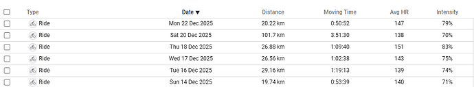

Yes I get something like that, but the data is not correct, don’t match with intervals.icu.
Missing workouts, and makes workouts up.
Me: Run Detailed 7-Day Report
result: data not correct missing data, hallucinates.

Metric Value Interpretation
Effort Type Recovery / Low Intensity Very light spin; active recovery purpose met
Intensity Distribution Z1–Z2: 90.4 % Z3+: 9.6 % Excellent recovery structure
FatOx Efficiency 0.63 (optimal) Efficient aerobic metabolism maintained
Polarisation Index 0.90 Strong endurance focus
Recovery Index 0.72 (moderate) Slight fatigue present, recovery ongoing
ACWR 0.94 Productive training balance
Fatigue Trend −13.4 % Recovering phase confirmed
Note the intensity distribution – 9.6% in Z3. But intervals.icu has this correct:
Z1 Endurance i1 0% - 67% … 30m3s 100.0%
Something’s gone wrong somewhere…
