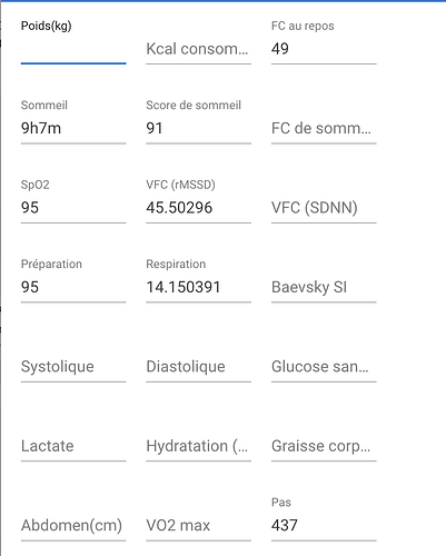

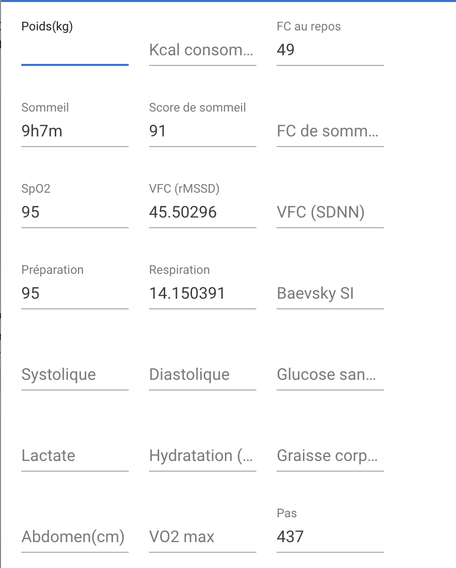

If you need, here is a screenshot of the health data given by the whoop on a given day:
FC au repos is Resting HR,
VFC rmssd is HRV rmssd
Score de Sommeil is Sleep score,
Préparation is readiness.
Respiration is respiratory rate (?)
Maybe it will help you test!
Thanks,
Olivier

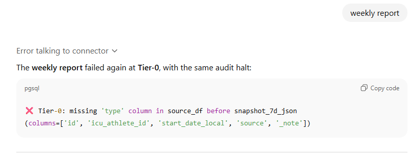

I have been getting this tier-0 error for the last couple days. I don’t know much about coding to troubleshoot this. Everything on the intervals.icu side looks complete.
Thanks for your help, I was having a lot of fun with this App last week.

After the recent fix related to the missing moving_time field, the Intervals ICU Coach v5 (Unified Reporting Framework v5.1) is still unable to generate a weekly report.
This time, the process passes Tier-0 successfully, but halts in Tier-1 with the following error:
Kopiraj kodo
:cross_mark: Tier-1: no valid activities after moving_time normalization
From what I can see, this means that although the moving_time field is now present in the API response, its values are either 0, NaN, or missing for all recent activities.
As a result, no valid activities remain after normalization, and the audit halts before metrics can be computed.
Could you please verify whether the API is currently returning valid moving_time values (in seconds) for activities over the last 7 days?
It seems that the structure is correct but the field values might still be null or not populated.
Is it possible that the problem is because my activities are imported from Strava?
Can you share you chatgpt chat via DM. I will endeavour to replicate your issue.
