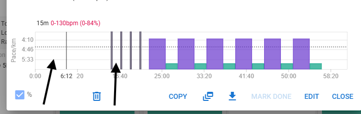

Why do I not get the skyline for HR syntax? I am guessing it’s because I am mixing HR and Pace?
Edit - Ya. The builder doesn’t like mixing HR/pace/power

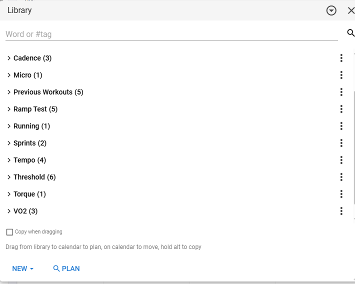

@david How can I save a workout for reuse so I can drag and drop it to another date later without having to re-enter the workout schedule?
Yeah, I think you have to enter a pace for that line too.
Just drag and drop it into your library. Then you can reuse it from there. Or you can drag and drop from one day to another, while pressing ALT (on Mac) or CTRL (? On Windows).
Thank you very much! (On Windows also ALT)
Create folder(s) in your library. Drag into those as appropriate.
