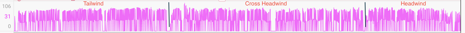

This is my cadence for a ride on Sunday that had sustained 20mph winds. Cadence was actually highest in the headwind section.

I am not aware of any strong evidence in the literature on this topic, so I will answer from experience and observation. It would be worth taking a close look at the quadrant analysis from the activity you shared above. As an interesting exercise, if you’re willing, feel free to share the .fit file with us.
