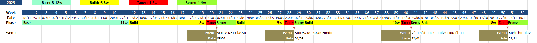

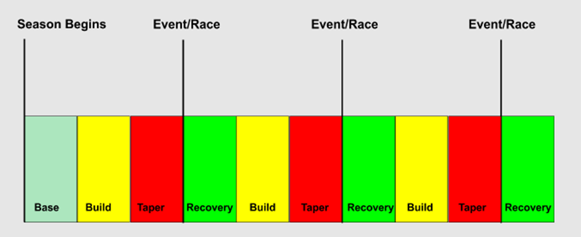

I have made a 12-month plan for myself and repeat it every year.
My goal is to have 3 to 4 peak times during the season where I plan some main events. So I have a goal to train for.
The main events are different for everyone offcourse.
For me those are a cyclo or gran fondo because these are a challenge for me an motivating me to train a whole year.
There are 4 phases:
  • Base
  • Build
  • Taper
  • Recovery
Base:
Duration: Typically lasts 8–12 weeks.
Focus: Building aerobic capacity, endurance, and foundational strength.
Workouts include long, steady rides at low to moderate intensity, with some cadence drills and light strength training.
3 blocks of 4 weeks:
The first Base Block shall be riding in Zone 2 or below 75% of FTP.
In the second block, add one interval session a week in zone 4 right at FTP or just below.
In the third block extend the intervals to 2 times a week.
Intensity: Low to moderate.
Volume: High, as this phase aims to build a strong aerobic base without excessive fatigue.
Build Phase:
Duration: 6–8 weeks.
Focus: Developing specific cycling skills and increasing intensity. Includes intervals targeting different energy systems,
such as threshold, VO2 max, and anaerobic capacity, along with continued endurance work.
Advanced abilities of Muscular Endurance, Power and/or Anaerobic Endurance are developed as they apply to your goals.
Intervals above Anaerobic Threshold are introduced, targeting the performance goals that your planned event requires.
Intensity: Moderate to high.
Volume: Moderate, with a focus on higher intensity efforts.
Taper Phase:
Duration: 1-2 weeks.
Focus: Achieving peak performance for specific events or competitions.
Workouts are short but intense, with high-quality efforts and ample recovery.
The focus is to get to the event with the highest fitness, minimal fatigue and optimal form.
Intensity: Very high.
Volume: Low, allowing the body to rest and adapt to the high-intensity work.
Recovery Phase:
Duration: 1–4 weeks, depending on the athlete’s needs.
Focus: Rest and recovery, allowing both the body and mind to recuperate before starting the next training cycle.
Intensity & Volume: Very low, with activities like easy rides, cross-training, or complete rest.
This gives us a 12-month planning with an example of 3 events:
For the year 2025 this is my visual timeline with all phases and events:
