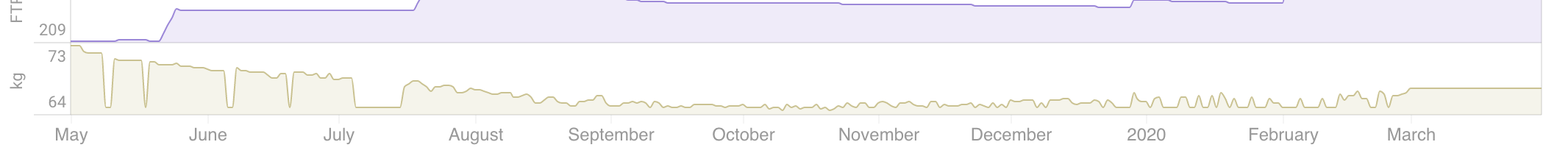

Yes, look at the chart, for every point in the past when in the Garmin serie miss a value, it is replaced with the present weight one.

I just noticed after importing all Garmin weight data that I have the same issue. As I weight myself once a week, 99% of the activities are showing now my current weight (which I entered manually while registering) which makes the graph not really usable unfortunately.

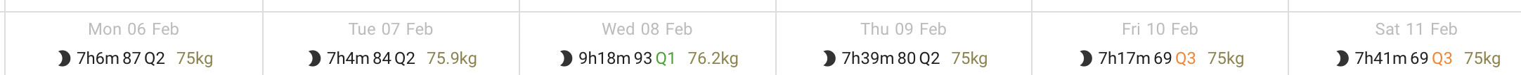

I would expect this to be the case, but it doesn’t seem to work, at least for me. For the days I don’t add weight to Garmin Connect, I get the “default” value of 75kg which is defined in settings.

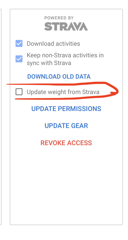

I was just going to explain that intervals.icu is the only place where I have my weight set to 75kg, and I’ve decided to check strava.com, which drumroll has my weight set as 75kg… :smiley:
I have deleted that value, will check if that helps.
Thank you for floating in my bathtub.
Edit: there’s a checkbox for that. :man_facepalming:
