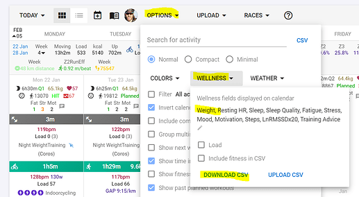

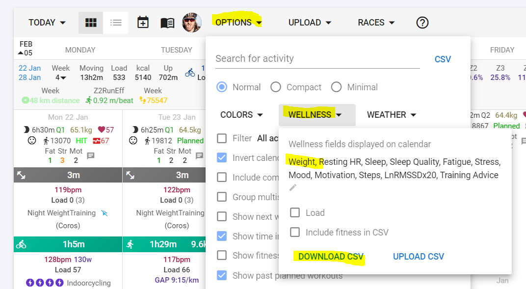

You can check the historical weight in at least two ways:
My guess is that your weight did not import correctly from Garmin for some reason.

  • If I download the Wellness Data as a .csv from intervals.icu as you suggested, the only weight present is today’s. Today’s weight did not come from the history file but from an automatic upload.

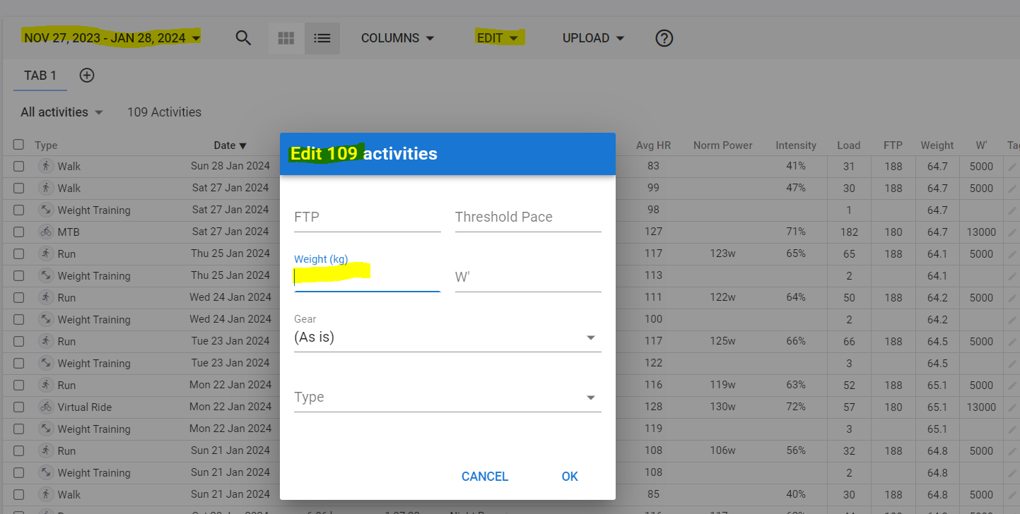

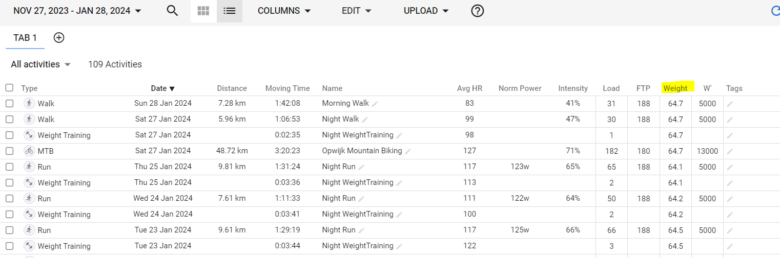

(2) You can bulk edit weight for specified time periods on the Activity List view

(2) I don’t think I can edit the weights that way. (a) There’s no “erase” button and (b) entering zero (or -1, which is supported in csv) results in a 'Weight must be between 45 and 660 lb" message. I can edit each calendar entry manually – but the edit doesn’t appear to persist because if I change views a couple times the weight reverts to the default set on 1/25/2024.
