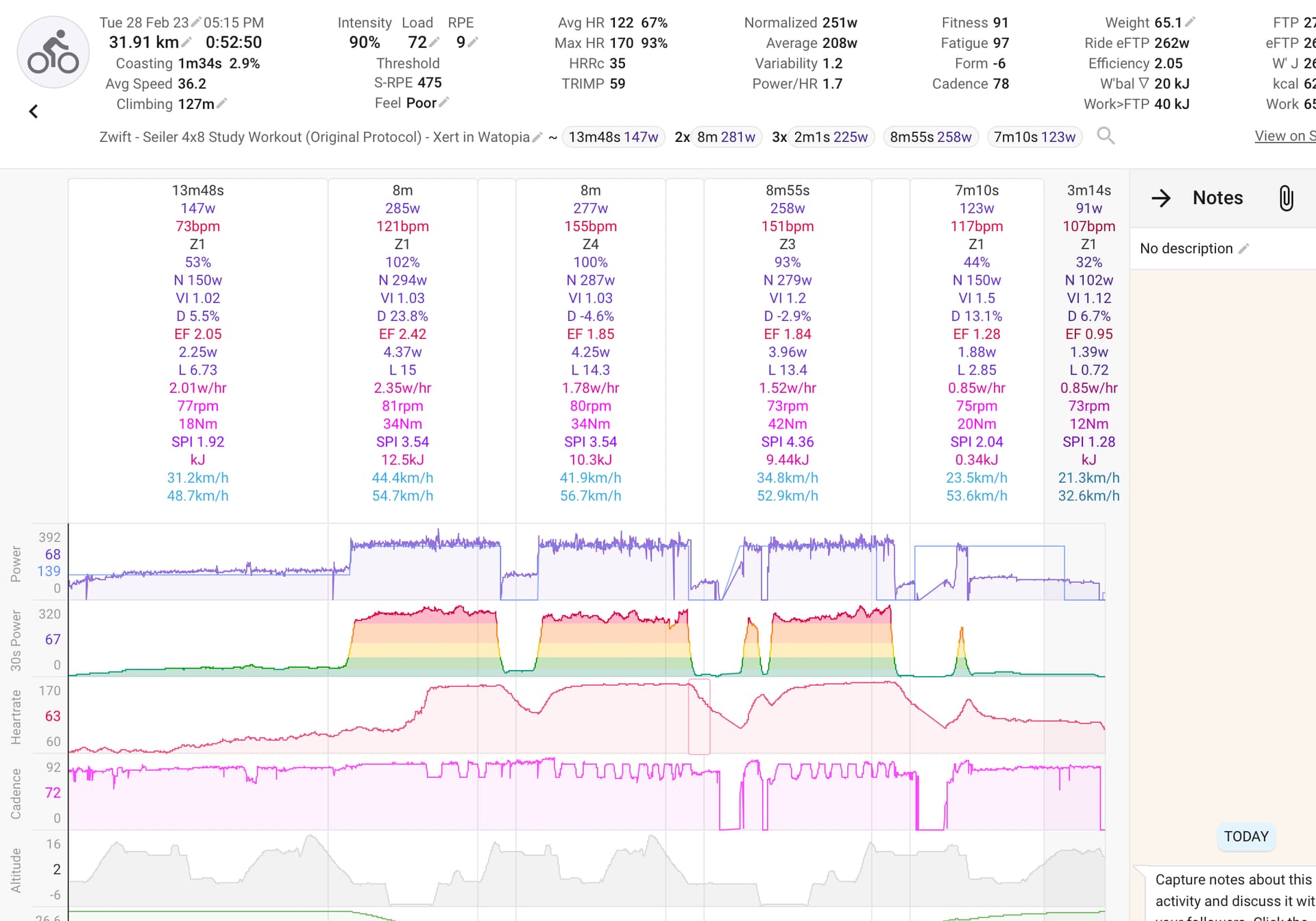

Hi David

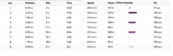

I have the .icu file and strava file below. These were 8min efforts and the power on both looks way off.
Sean
https://intervals.icu/activities/8577051681
https://www.strava.com/activities/8572139870/laps

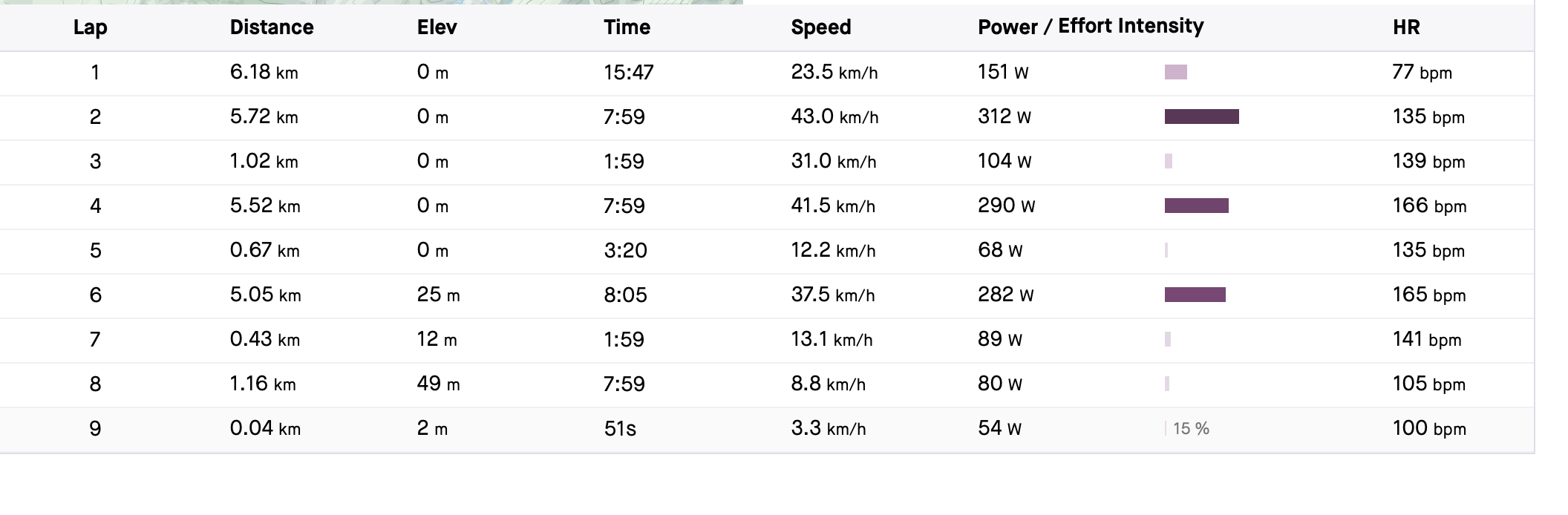

Ah this is more bad lap data from Strava. Do you have privacy circles turned on? Strava often messes up the lap data given to Intervals.icu if you do.

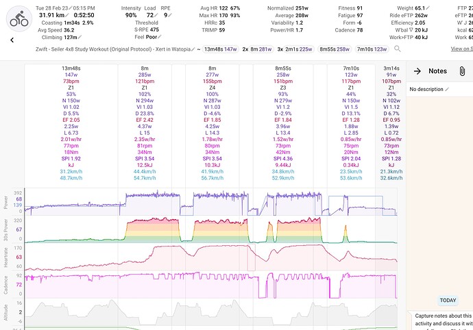

Those are very neat intervals. The automatic interval detection will probably pick them up. Do Actions → Analyse and untick all the boxes and see what you get.
Yes ive privacy set up, I’ll untick and give that a go. Thanks for help here I appreciate that.

I’ve previously asked Strava to turn this feature off (or allow the option to) turn this off for virtual rides.
Sadly they’re not quite as efficient as David so if you have the time adding another ticket will help
https://support.strava.com/hc/en-us/requests/new

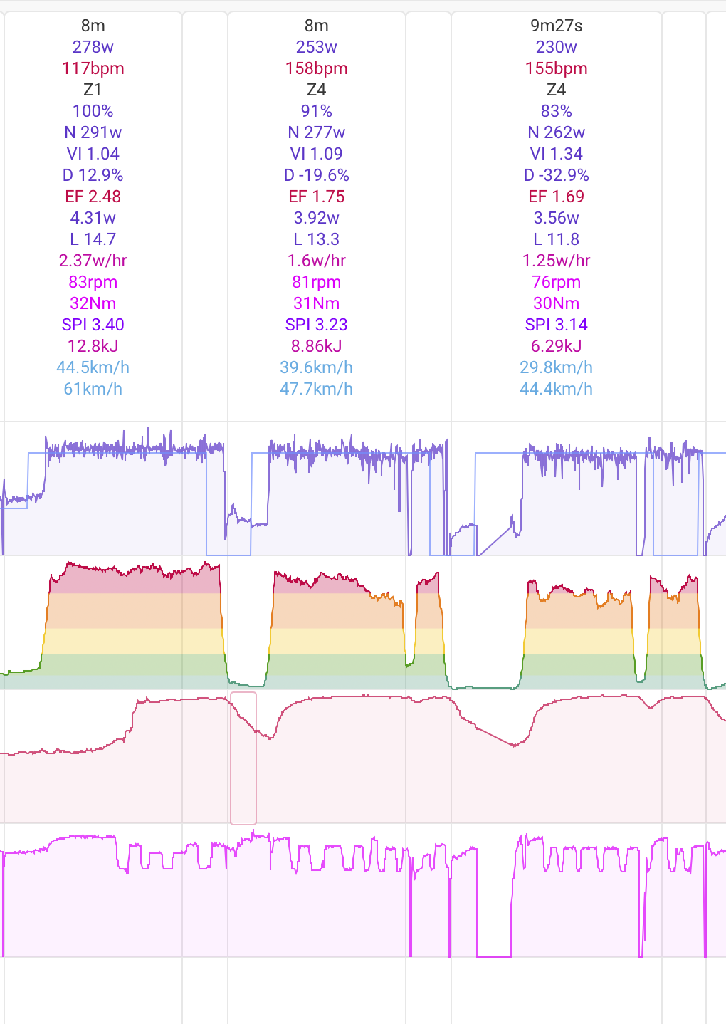

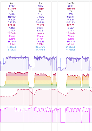

I will try sending a ticket as the data I’m getting is way off, anything I can do in meantime. Ive tried @David suggestion to untick but no joy im afraid.
I’d just delete them all and add manually personally, press D to delete (when hovering over) then A to add new ones and just drag the boxes to the correct bits
I’ll try that , thanks for tip but shouldn’t really have to be manually editing intervals. So is the consensus this is a Strava bad data issue and nothing can really be done by .icu
Sean
Yes unless Strava fix the bug Intervals.icu can’t really do anything much about it.
