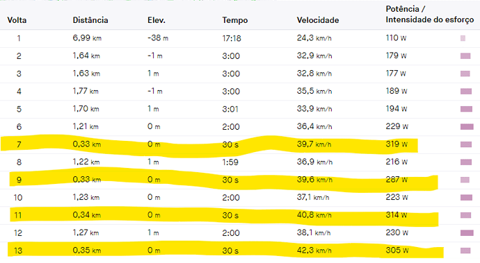

I’ve double check just to make sure … the 3 first 30 seconds sprint (Always AVG WATTS)
INTERVALS
1- 231
2- 215
3- 231
STRAVA
1- 319
2- 287
3- 314
TRAINING PEAKS
1- 323
2- 287
3- 318

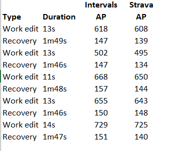

My 15s sprints from yesterday:
Very close … but it should be 100% the same, no?
If you think you getting this info from strava, so it should be the same …
  1. It should be the same. I agree.

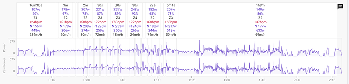

Add RAW power chart and post a screenshot with regular and RAW power traces for a zoomed in interval.
Sorry MedTech, RAW power is a chart that I can add in Intervals?
I couldnt find

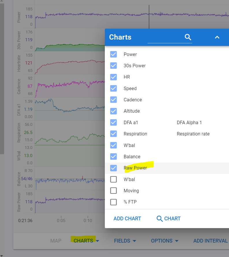

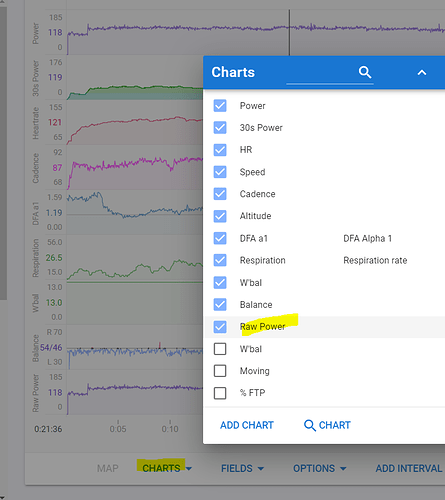

Activity page, Charts, select Raw Power.

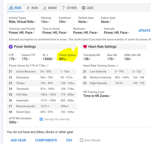

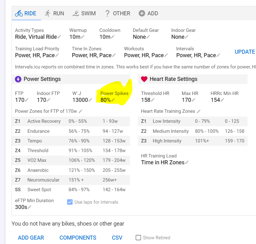

Intervals clips ā€˜unrealistic’ spikes in Power following this setting
Raw power shows the unedited Power trace.

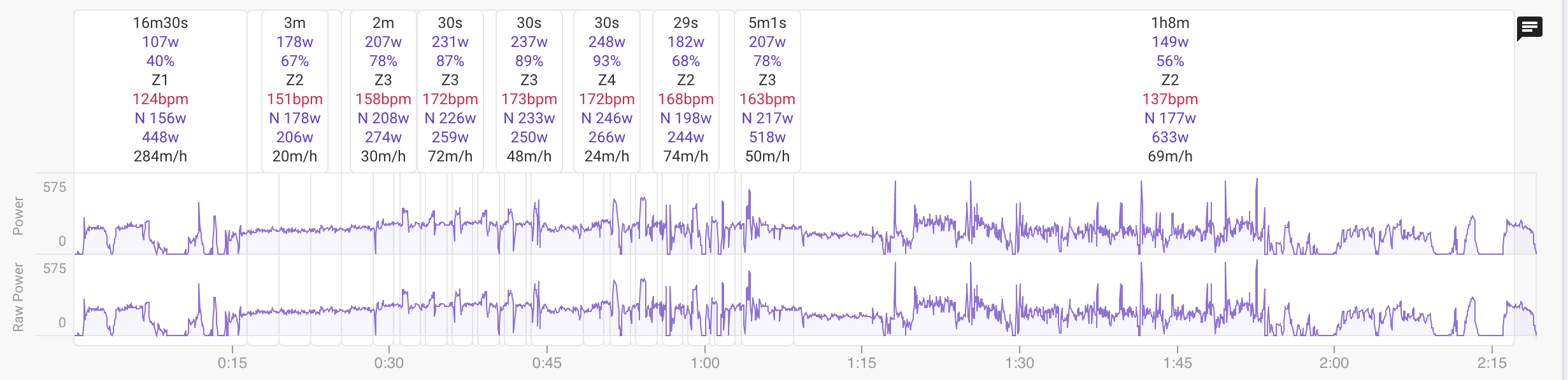

Do you have Strava privacy circles turned on? That can cause Strava to give Intervals.icu bad lap data. If you look at the chart that 30s interval (number 7) misses the 30s power jump. That is why the power is so different.
Just to confirm what @Gerald said. Intervals.icu computes all the interval stats and so on from the power, heart rate and so on traces and does not use the summary information from the device (which may be different). This is so you can edit the power, fix anomalies and so on in Intervals.icu.
@MedTechCD the raw power is exactly the same!
