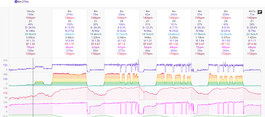

I do Vo2Max, 4x8m @ 106% FTP intervals. I do the first one without any problems, in the following intervals, unfortunately, due to leg pain (not breathlessness), I have to take breaks.
How do you think it is OK? Is it better to reduce the power or shorten the time? Do you leave it as is? Personally, I think I’ll leave it as it is.
Are you sure your FTP is set correctly?
The fact that the 8m 280W is a record for you, I think it’s not.
106% is the absolute lowest part of the VO2-range. Maybe shorten the intervals.
I’d have to do my fitness tests to be sure :slight_smile:
I have FTP set to 265W. 2 * 20m training on 91% FTP I do without a problem.
I’m going for over 2 hours on 200W (75% FTP) aerobic decoupling I have less than 5%. and average heart rate of 144bpm. When I do a test with HRV with DFA a1, everything is below LT1.
This record is only from this season.
This season I am just starting Vo2Max intervals for 8 minutes doing.

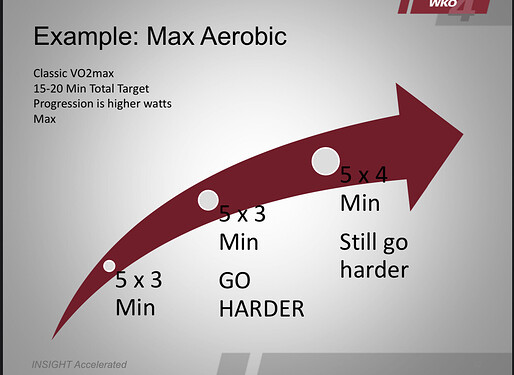

The most “advertised “ VO2 max workout is the 5x5m.
The desirable rest period is 2m but you can make a progression here too. Starting with 4m than 3 up to 2.
