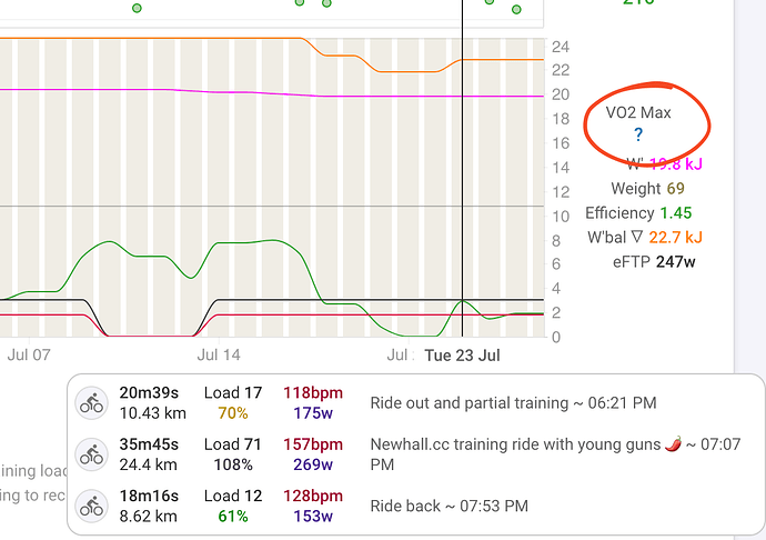

Can anyone help. I’ve managed to get VO2 max on wellness data for cycling via garmin but it won’t appear in charts?
