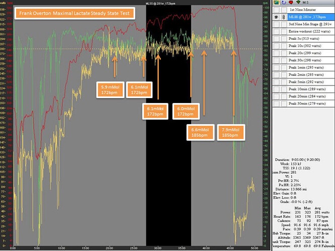

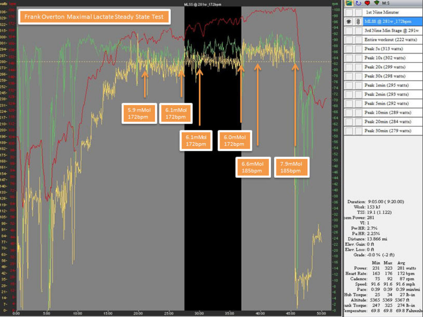

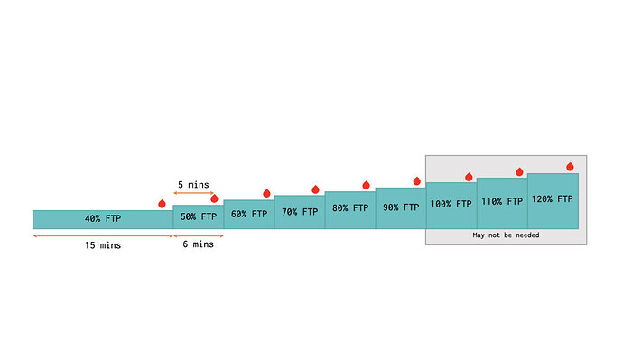

I used to be coached by FasCat, and in the old days they used to do MLSS testing. Here is some info on their website:
that is the FasCat viewpoint, based on their experiences.
Another one worth reviewing:
For more, you might try searching “maximal lactate steady state protocol” or “maximal lactate steady state testing” and/or add the word cycling to find other info.
