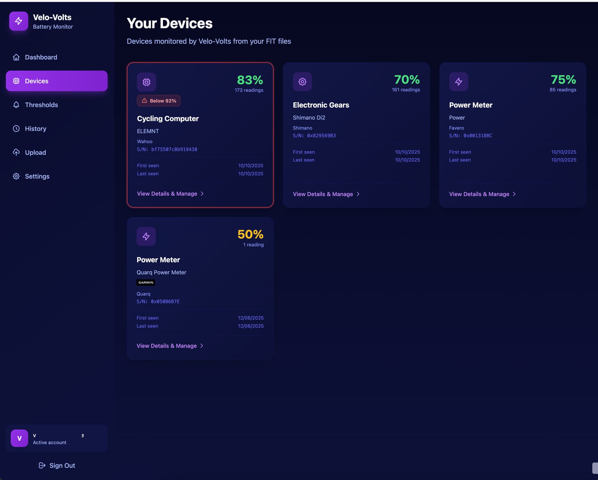

I decided to build a small service called Velo-Volts to solve this. It’s a free, community-oriented dashboard that monitors the battery health of your electronic gears and sensors automatically based on your individually configured preferences.
How it works: It pulls the .fit files directly from your uploaded activities. Instead of just seeing “Battery Low” when it’s too late, it tracks the status across every ride so you can get notified when and how you want to.
Key Features:
  • Auto-Sync: Supports Garmin Connect and Wahoo Cloud syncing.
  • Flexible Flow: You can also sync via Dropbox, automatic email forwarding, or API/manual upload.
  • Sensor Support: Di2, SRAM AXS, Power Meters, HRMs, Radars and more (basically anything that writes battery status to the fit file and i’ve seen so far).
  • Progressive Web App (PWA): In addition to push notifications on your computer or email alerts, we also support adding Velo Volts to your phone by adding it as a PWA, allowing you to get real time push notifications by mobile as well.
  • Privacy: I built this for the community, so I’ve kept it lean. No trackers, just the data sharing needed to show you your battery status.

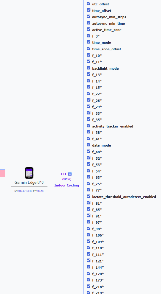

If the info is in the FIT file, Intervals Custom Activity Fields could be used. You probably discovered some of those un-named fields and that info would be welcomed here. And at least one other dev is looking to get as many details as possible for all those hidden/unnamed FIT file fields - gotoes.org has now the possibility to show all those fields, but there is still a lot to be identified.
You could certainly use the Intervals API to pull the FIT files from, Intervals already is connected to a lot of platforms and that should make it easier for your app if you can get all the FIT files from the same source.
You mention HRM’s but screenshot isn’t showing one. Just to be clear, it can show battery voltage from a Polar H10 strap?
Gonna give it a try and I’ll report back with other comments.
Here’s a screenshot of ~1/4 of the existing fields in a Garmin FIT file detected by gotoes.

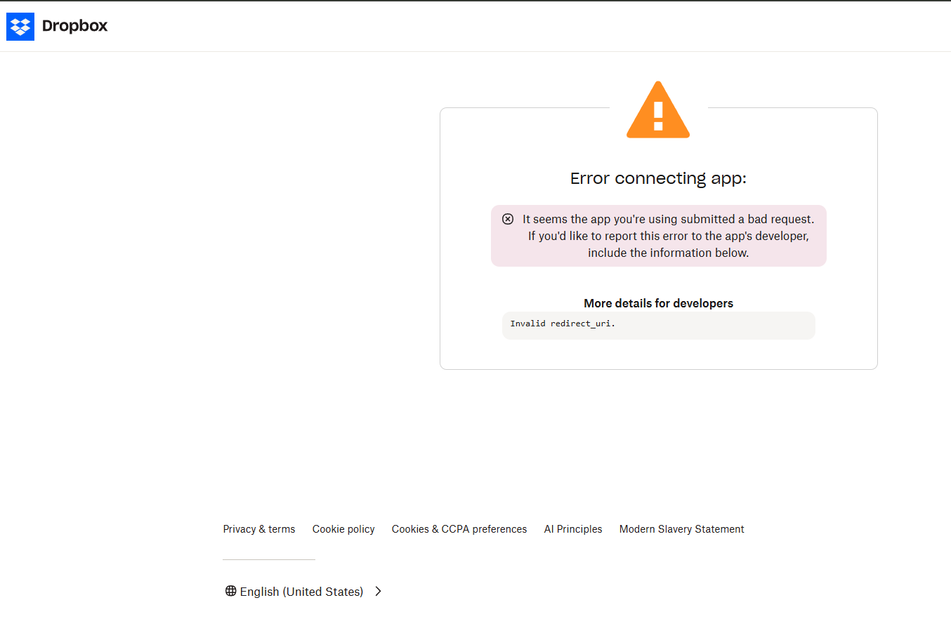

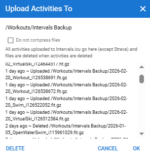

Could be useful but the Dropbox sync does not work unfortunately. And will it recognise the compressed file format fit.gz that Intervals uses for back up?
Thanks for making me note the compression, the main focus has been to directly integrate to wahoo and garmin to provide a seamless experience outside intervals.icu as well! But i’ve now gone ahead and squashed the bug you were encountering during your onboarding, and also added support for consuming the compressed backup files from dropbox backup, in parallel to the pure .fit files!
Hope it works in your end as well now?
Success.

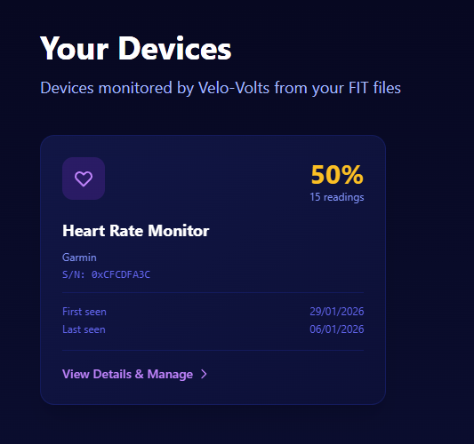

This is really cool! I setup the app straight away and it mapped all my devices: 2 power meter, SRAM gear, 1 cycle computer, 1 radar and 1 HR band!
Can you also add Stryd? It really annoying start running and figuring out the pod is running out of battery!
