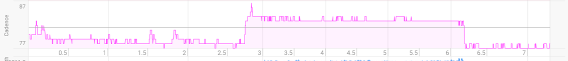

Your jittering cadence (as well as the other running dynamics) charts at present coming from the wrist watch sensor:
will turn in something like this, coming from the Stryd foot pod:

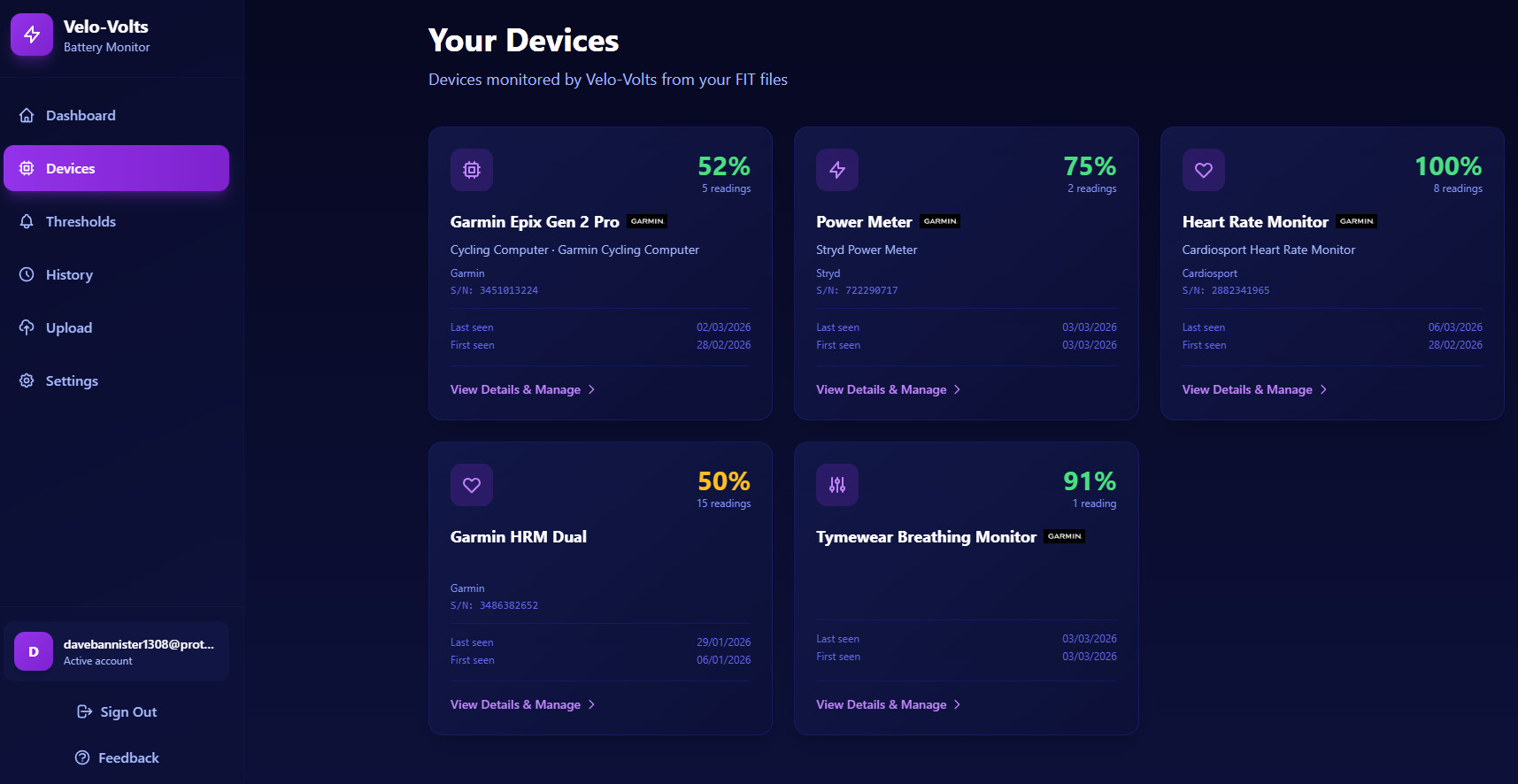

I have done two very brief tests of what devices show up. Tymewear breathing sensor shows in both FITs though not in the Battery Staus Mod
The first had the Stryd & just the Tymewear breathing sensor active.
The second has the Stryd, Tymewear breathing sensor & Tymewear (shows as Cardiosport) HRM
Hopefully I have done this. i will test tomorrow. Thanks

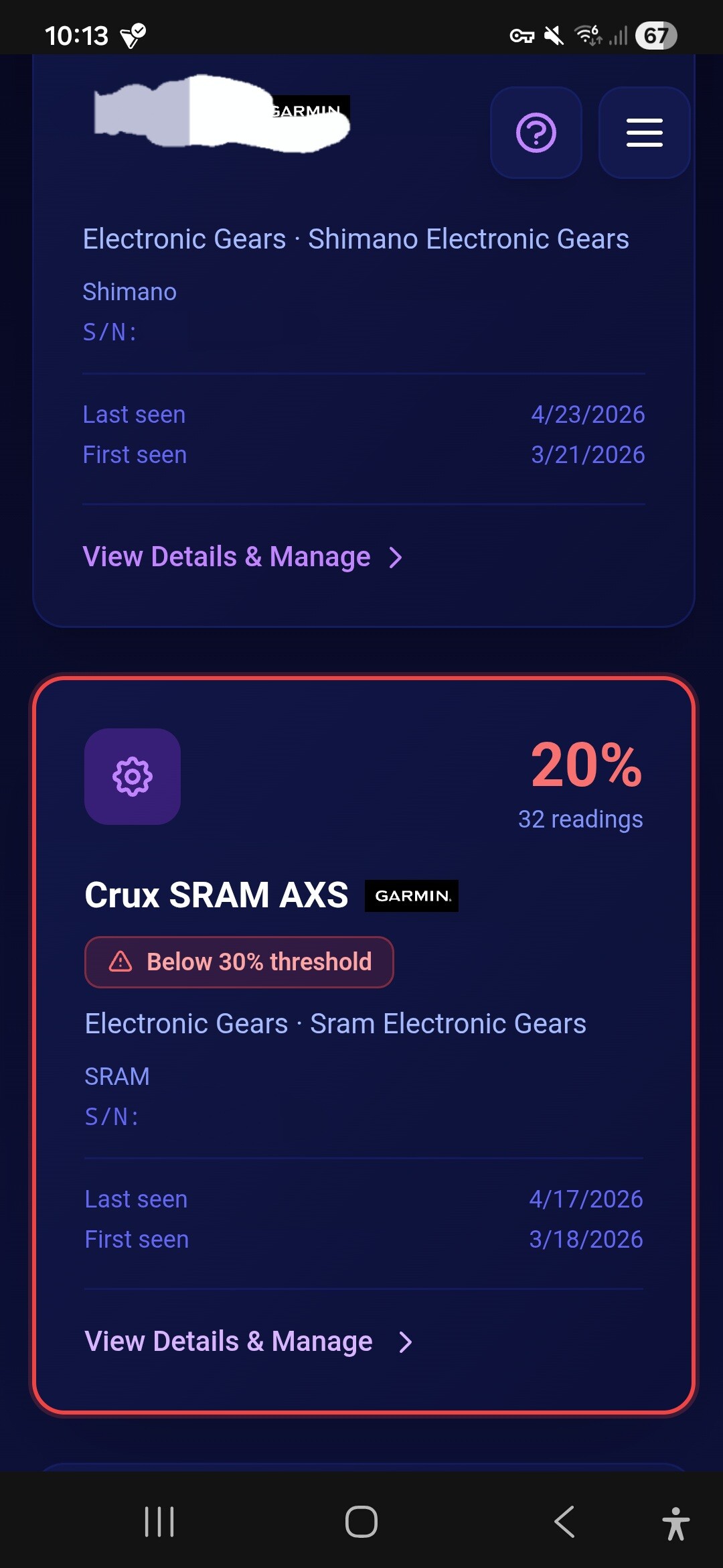

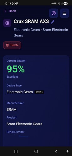

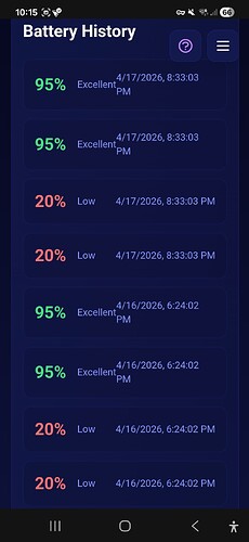

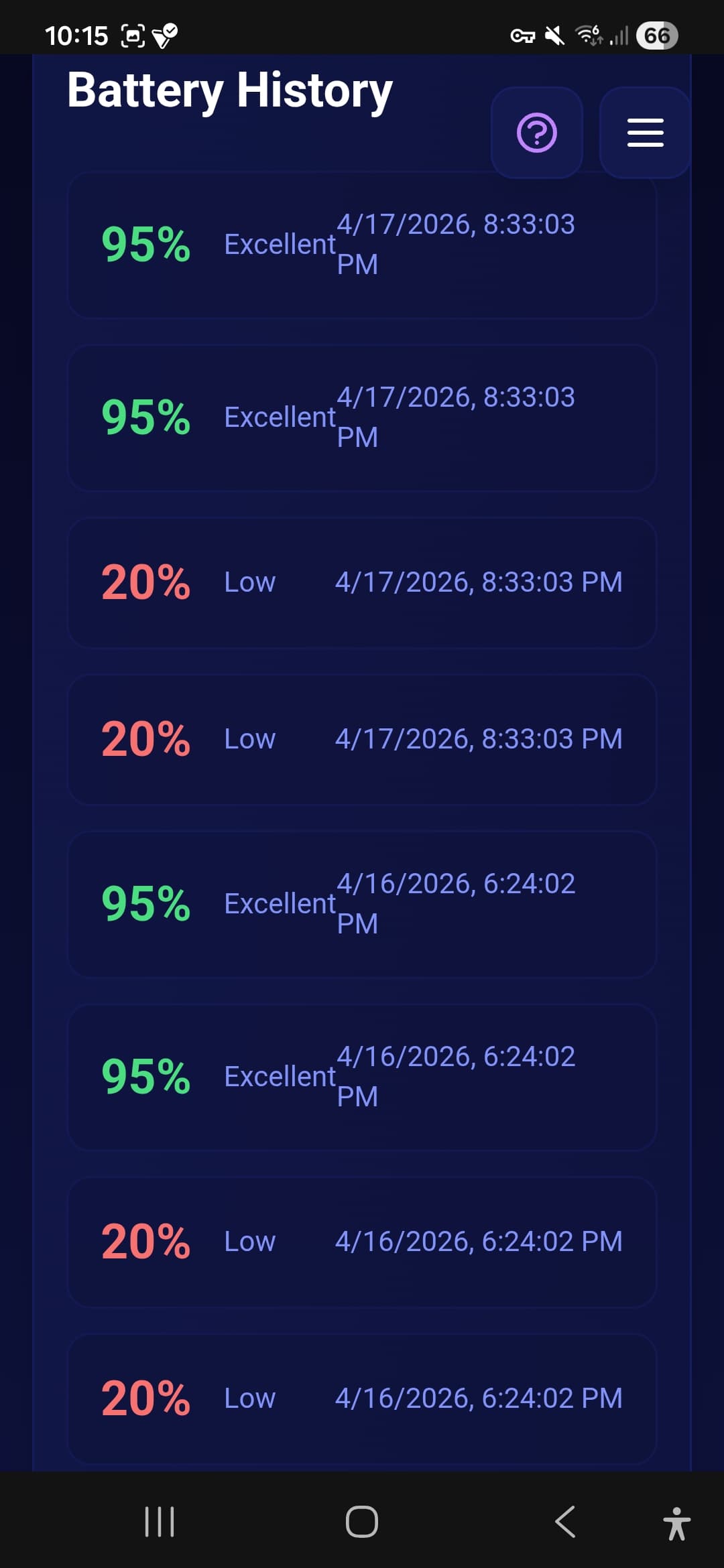

@Velo_Volts

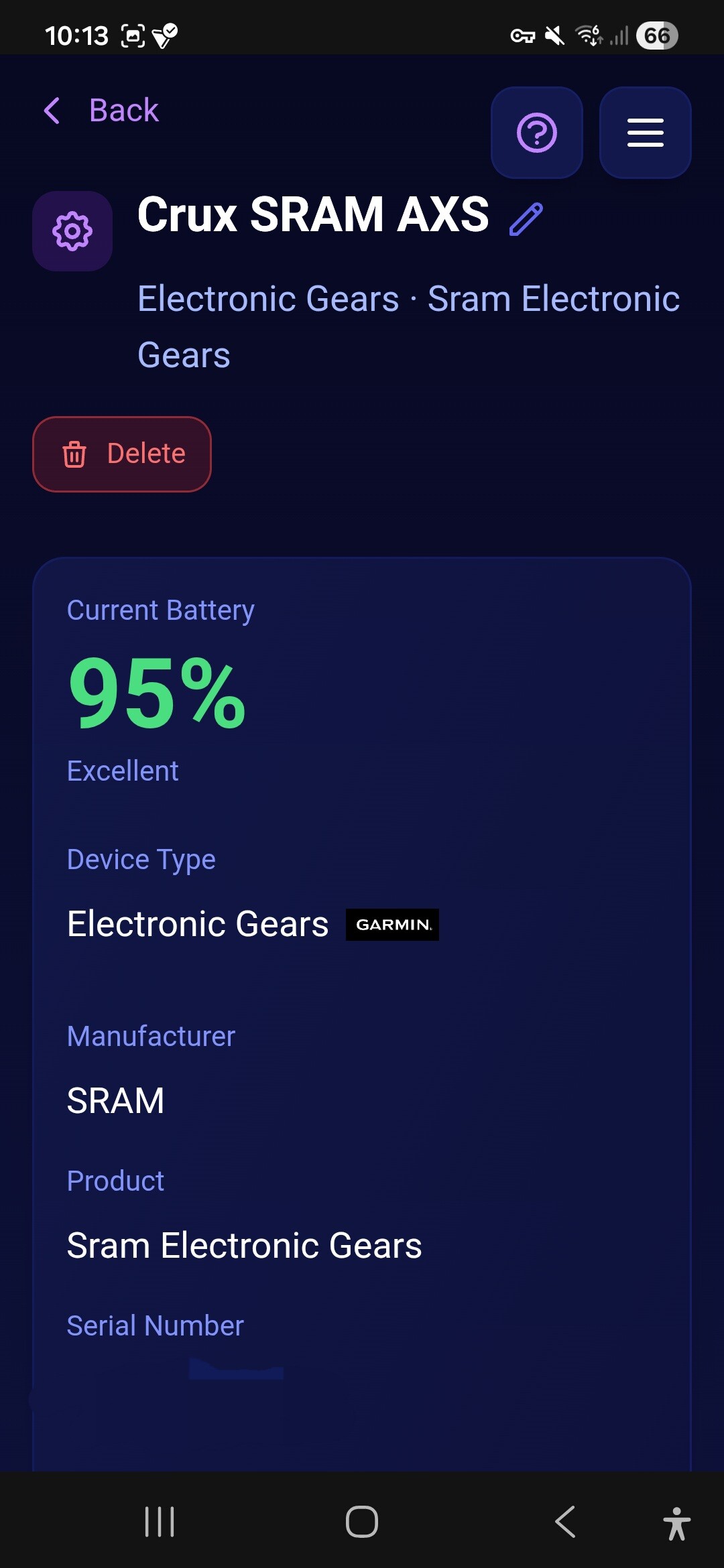

I get some strange results: battery level reported low (20%), general summary page shows that . Once in the device itself battery level is displayed as 95%. The history secion shows readings from within seconds of eachother wirh both those results…
Is this a bug or do i miss something?
@Alpaka That looked very wrong indeed!
We have tried to iterate on the sub-component parsing we added recently and it should be much better for your scenario going forward.
We really appreciate the feedback here. Let us know if everything looks better in your end and if it works like you would expect it to?
