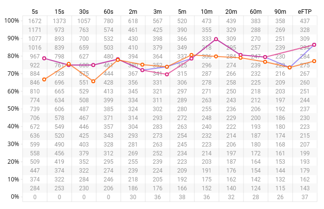

So to conclude this, i finally hit my goal of 300W eFTP (well 298W, close enough).
Bildschirmfoto vom 2024-12-13 18-01-49

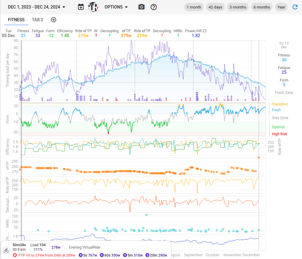

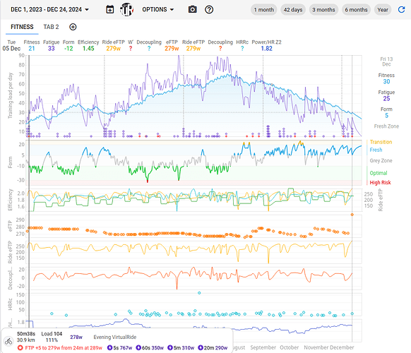

Looking at my year activity, I have no idea why though. I have really no idea. I trained a lot more, with much more structure in 2024. But it didn’t pay off in Watts (checkout the eFTP chart) . Now I thought, I was in a general winter decline and suddenly I get this big peak on a 1h Rouvy Race (@10m).
It’s peculiar that my last best effort is almost exactly a year ago. Maybe just getting fatter in the winter and doing less, is better for the FTP ?? :wink:
So my next target is 320W. I have this idea, that doing some weight training might get me there. Even an old guy is allowed to dream…
