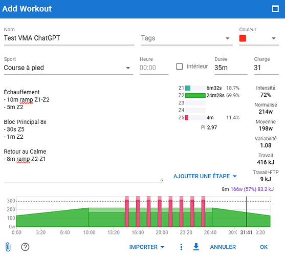

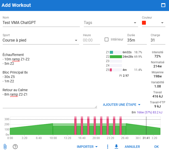

It took me few prompts but it worked :smiley: I’ve asked a sample workout to illustrate. Originally when I used your prompt (that I had to translate in French, also using ChatGPT) it was formatting workouts with rpm for cycling but as I’m using Stryd and CP I have provided my power zones.
