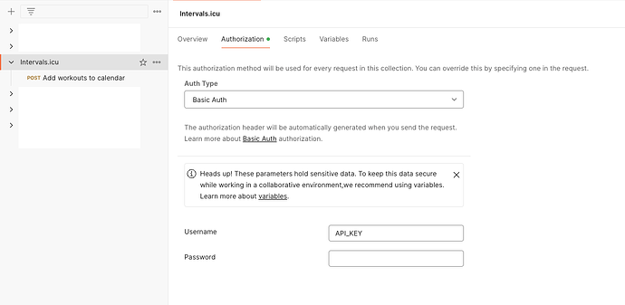

  1. download and install Postman
  2. left panel, “My Workspace”, create a new Collection (+ button)
  3. select your new collection and in the authorization tab select “Basic auth”, then insert “API_KEY” as username and your api key (found in your intervals.icu setting page)
  4. in this newly create collection add a new Request
    URL: https://intervals.icu/api/v1/athlete/0/events/bulk
    change type (left to URL) to POST
    in the “Body” section select Raw and paste your json
  5. Click “Send”
do a test with couple of workouts otherwise if something is wrong manually delete all the calendar entries could take some times
