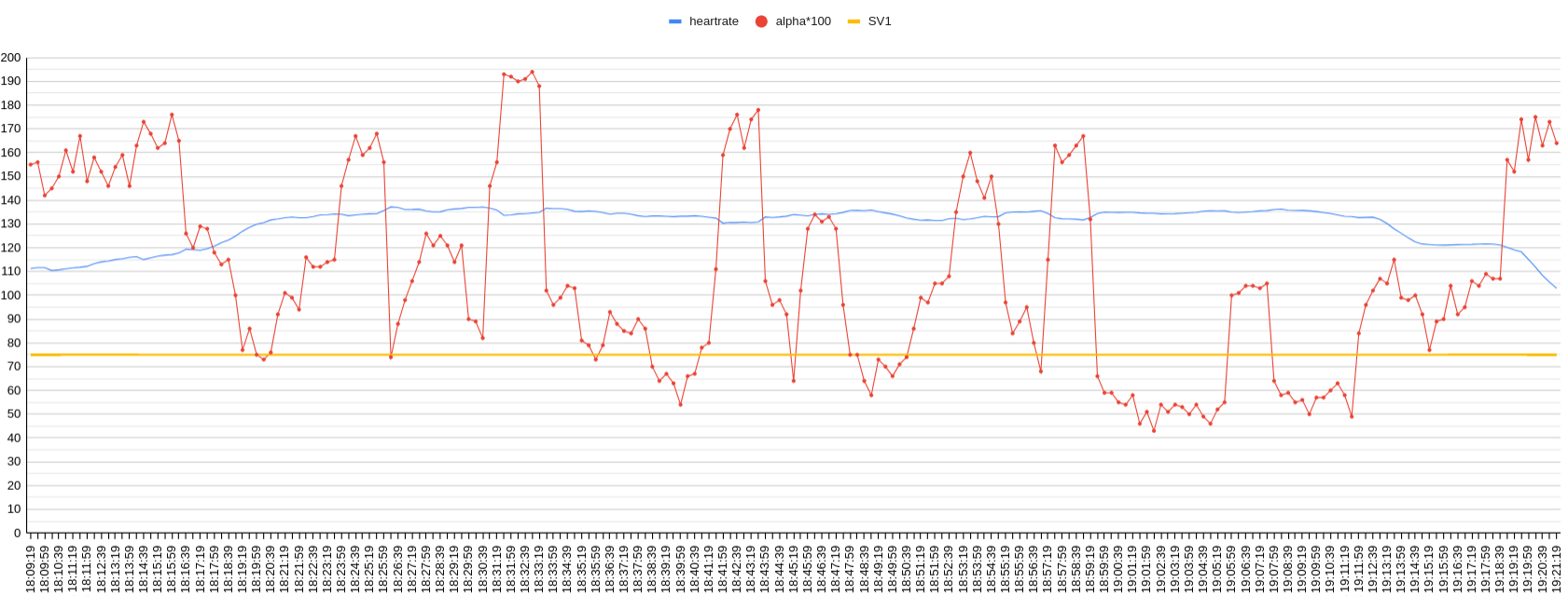

I’m trying to use DFA-alpha1 value to train around VT1 on my home trainer using the Fatmaxxer Android app. I have a heart rate monitor (polar H10) and a power meter.
I’ve done a ramp test to find approximately my heart rate and power at VT1 (when alpha-1 reach 0.75)
Then I’m trying to train around these targets, monitoring the alpha-1 value with Fatmaxxer.
I’ve a Polar H10, I’ve taken care to use BLE and there are very few errors during the recording.
I was expecting to be able to reach a value slightly above 0.75 and maintain it approximately above this threshold. This is not what I get. I get a lot of variations, from 0.75 high up to 1.9, despite having a near constant power (no more than 10W variation) and HR. You can see the graph (there’s a 10 minute warming up and 7 minute slow down but otherwise it’s almost at constant power and HR). At the end I tried to stay at the high end of power to see if value would still go up again (it remains below 0.75 except for a small time so maybe it was too hard for this period).
Is is expected to have such variations ? If that’s the case, what should be the goal when looking at alpha-1 value ? Should I try to never go below 0.75 ?
Thanks for your feedback and advices !
You can’t really use Alpha 1 for continuous monitoring. You have to use the HR/Power values found in a ramp test.
You can check a1 as an average to see if your values for a specific day are more or less normal. If a1 looks much lower then normal, it could indicate fatigue.
Now from your graph I would still think that there are regular non-corrected artefacts. Simply because every high ‘block’ looks like it is approximately 2 min wide. And a1 has a 2 min calculation window, so each artefact causes a complete 2 min window to be ‘off’.

Scanning your graph and visually filtering out the blocks caused by errors, the trend seems to hoover an a1 from 0.6 to 0.9 which is OK.
