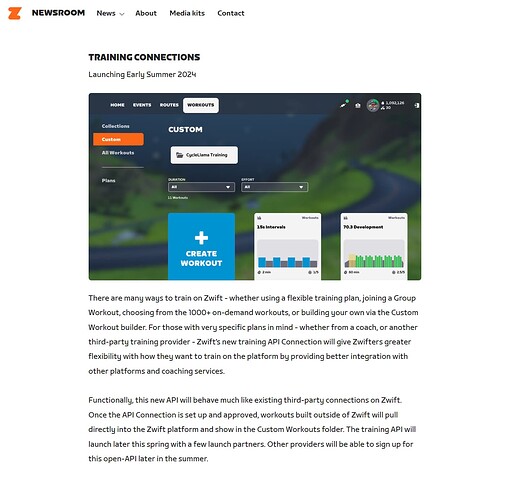

Hi, Is it possible that this news could facilitate the integration of intervals with Zwift?
Training Connections
"There are many ways to train on Zwift - whether using a flexible training plan, joining a Group Workout, choosing from the 1000+ on-demand workouts, or building your own via the Custom Workout builder. For those with very specific plans in mind - whether from a coach, or another third-party training provider - Zwift’s new training API Connection will give Zwifters greater flexibility with how they want to train on the platform by providing better integration with other platforms and coaching services.
Functionally, this new API will behave much like existing third-party connections on Zwift. Once the API Connection is set up and approved, workouts built outside of Zwift will pull directly into the Zwift platform and show in the Custom Workouts folder. The training API will launch later this spring with a few launch partners. Other providers will be able to sign up for this open-API later in the summer. "
This would be amazing! I am self coached and use the workout builder in intervals and then manually import them to zwift. An export feature would be killer
I have already mailed Zwift asking for Intervals.icu to be included in whatever beta they have going. If that doesn’t happen I will certainly implement this ASAP when it is launched.
