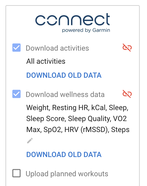

hello,
Seeing the planned workouts in Garmin calendar was worked perfectly for years, but since 2-3 weeks it does not work any more, but connection still exist. Do you have any ideam how can i fix it?
It worked on my accounts just now. Issue must be limited.
You have “Upload planned workouts” unticked in the Garmin box in /settings. You need to tick that box.
Hello David, Thanks I did not see this option. Now it is fine !
