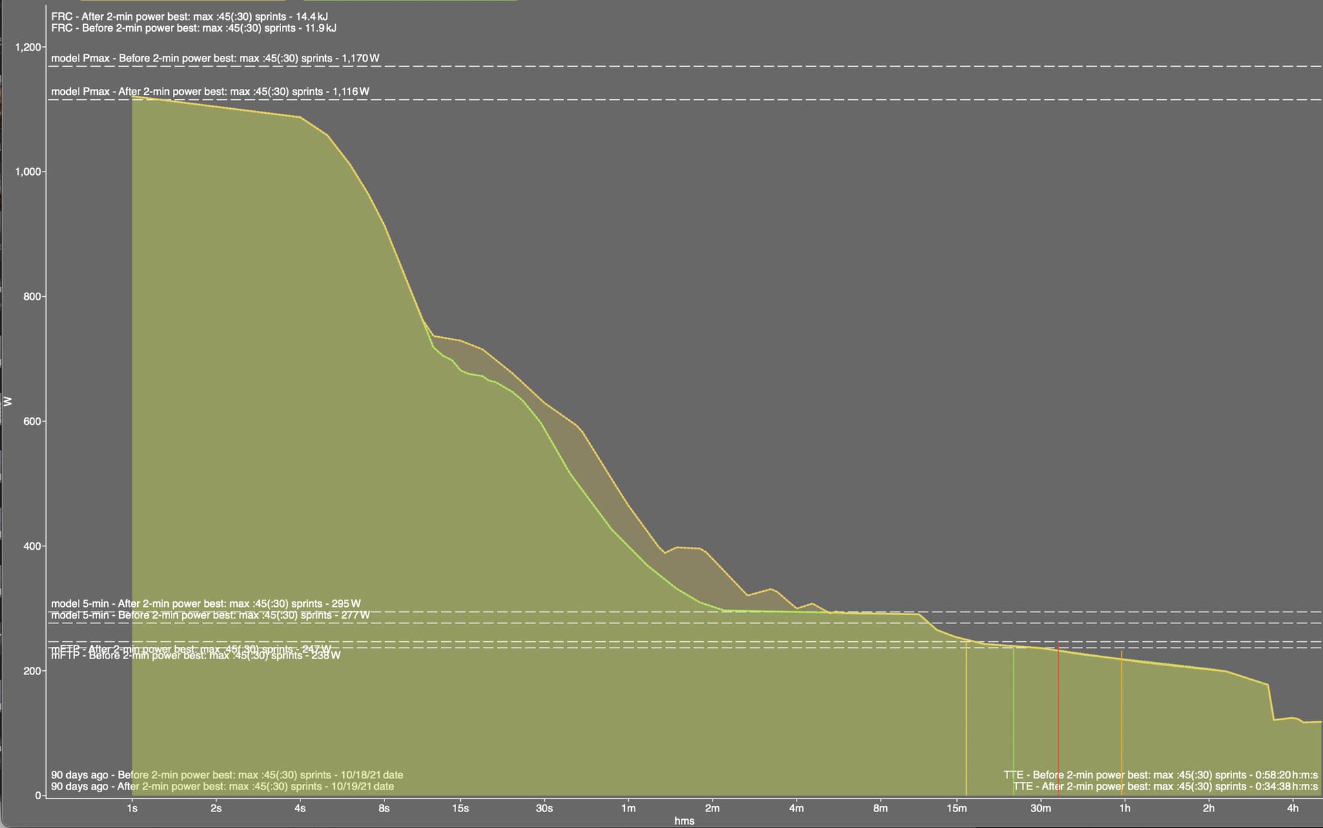

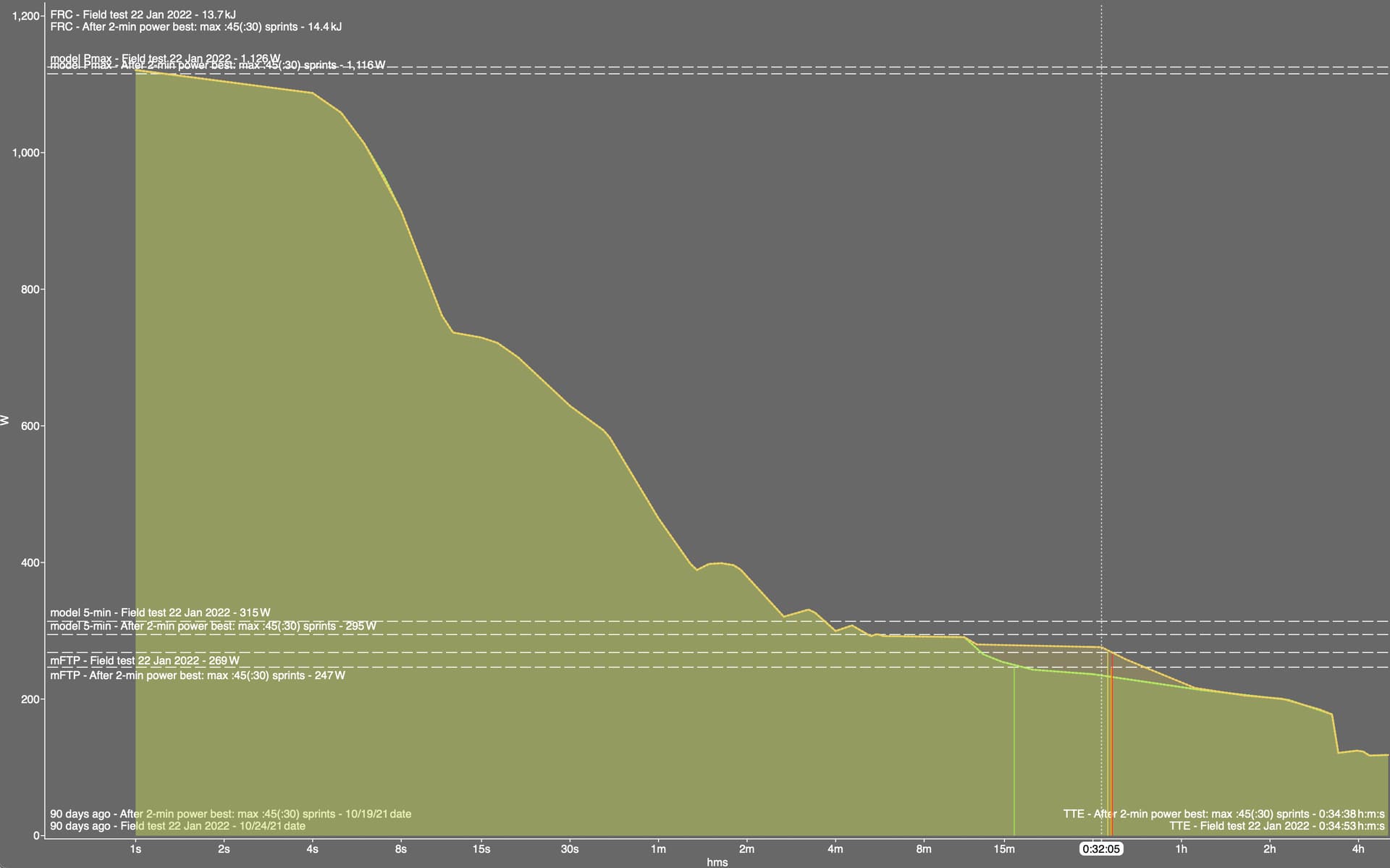

Here is 90-day WKO model for the day before and day of a glycolytic effort (Instructions were MAX Sprint 6 x 45-sec (30-sec off) )
mFTP increased from 238 to 247

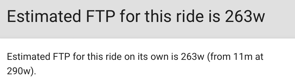

A week or two before I did a “do 2x10-min pacing at your 20 min TT pace” which was 291W for 11 minute effort. This was January and I hadn’t been doing any threshold work. You can clearly see the drop-off at 11-minutes.

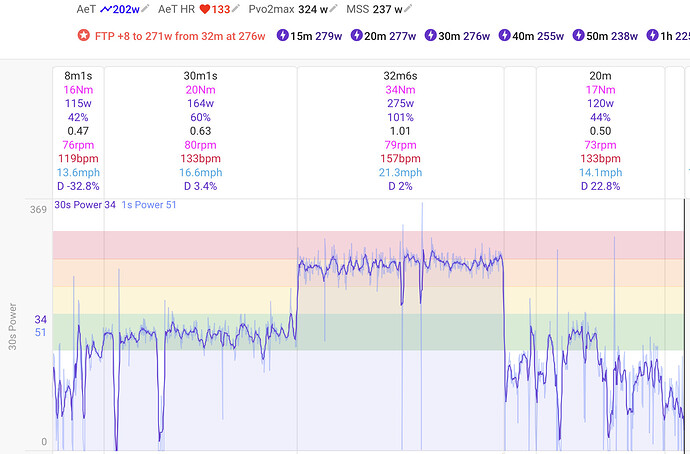

and then 5 days later a 32-minute long test where I ran out of road, but could have kept going as I was operating right at my threshold (276 for 32-min):
mFTP increased from 247 to 269. But not a max effort. Only a near max.

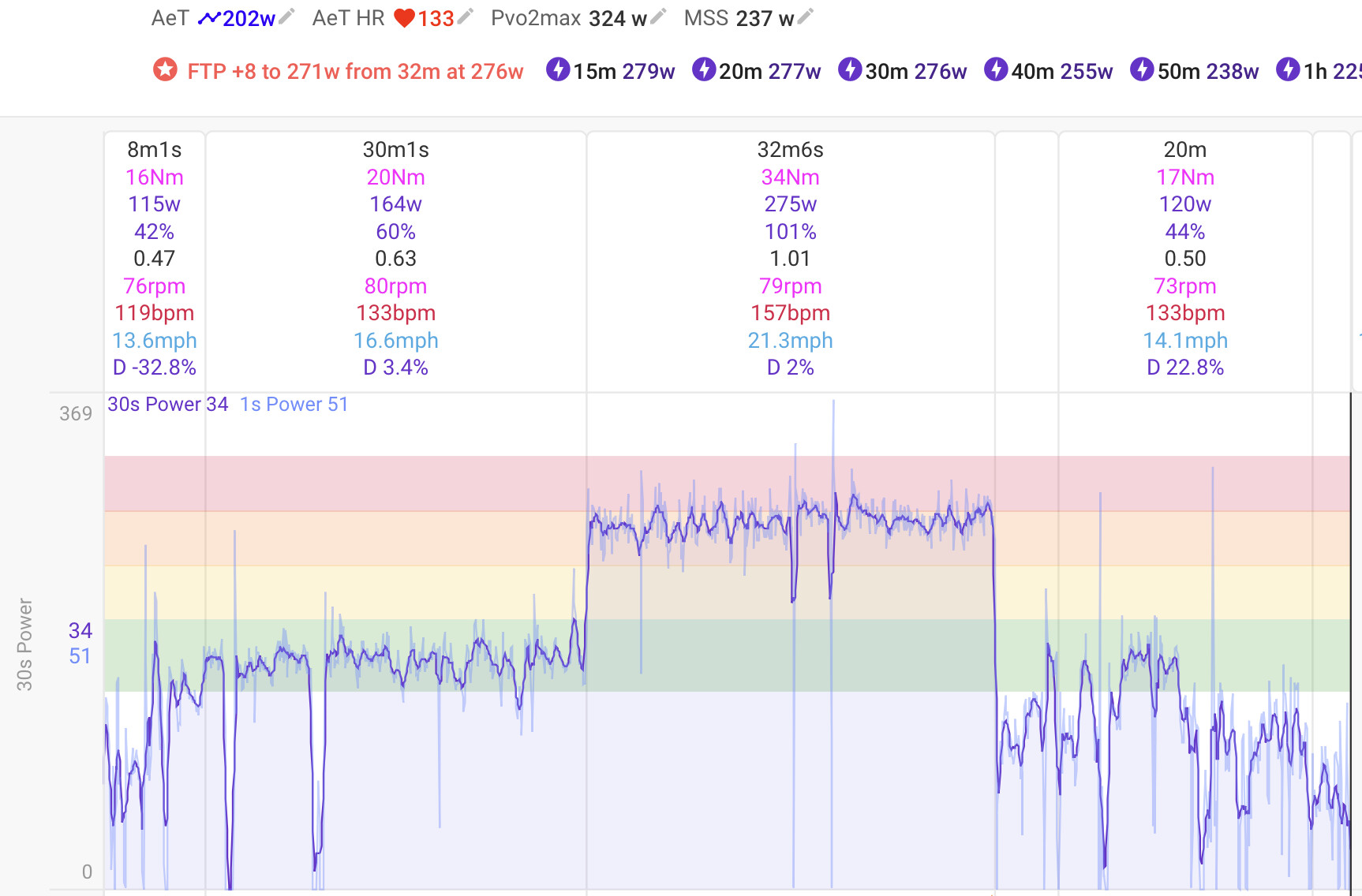

here is that long effort in Intervals:

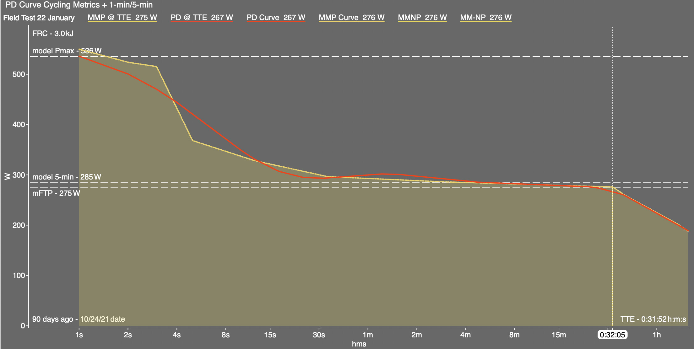

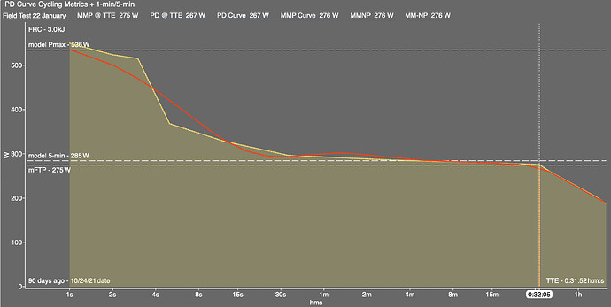

and the MMP / PDC of just that 32-min effort in WKO5:

22 January: long field test:

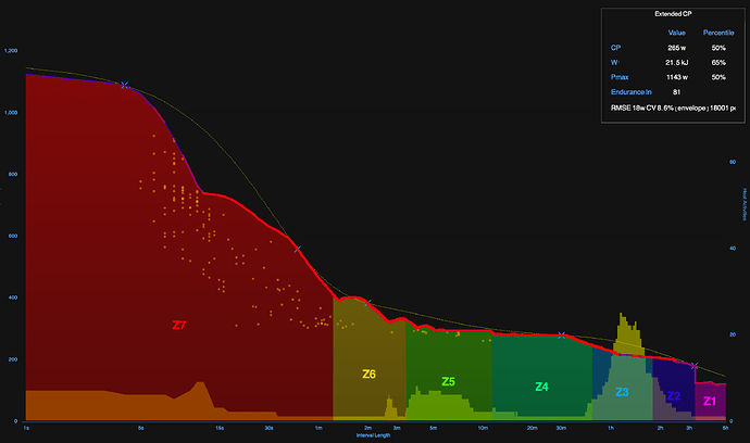

And GoldenCheetah:
266W eCP 2-parameter / envelope
278W eCP 3-parameter / envelope
265W eCP Extended / envelope
Re: your MSS I still have trouble understanding. For the 32-min effort (not max, could have gone longer) it estimates 237W. But I did 276W for 32-min and could have kept going longer, at least to 45-min, maybe longer. Of course your eMSS doesn’t know that.
