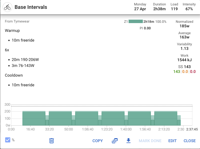

I usually create workouts myself in Intervals. But out of curiosity, I tried uploading a recommended workout from Tymewear into Intervals. It uploaded, but I had to make a few small adjustments :slightly_smiling_face: I think it’s just a matter of time before they refine it.
For example, for running they have this structure — they just didn’t include the pace value.
Warmup
  • 10m freeride
5x
  • 3m 3:32-3:45/km
  • 3m 8:38-15:07/km
Cooldown
  • 5m freeride

When exporting running workouts from Tymewear to Intervals, the pace name are not included
The 3-minute intervals are meant to be done at VO2max pace.

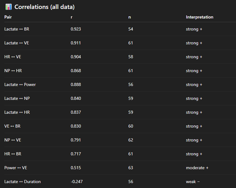

I have been using lactate in my training for quite a long time. I record these measurements for statistical analysis with Tyme data.
Recently, I did a summary analysis of the relationships between lactate, power, heart rate, ventilation, and breathing rate across almost 63 workouts. The results were quite interesting.
Short summary
  • After controlling for duration:
    • VE remains the strongest predictor of lactate (r = 0.90)
    • NP is slightly weaker, but still a strong signal (r = 0.82)
    • HR is the weakest of the three, but still strong (r = 0.79)
Ventilation (VE) demonstrates the strongest independent association with lactate, even after controlling for duration, suggesting it captures metabolic intensity more directly than HR or power.
Can you share the time/period with this comparison ,and total number of sessions?
Total of 63 measurements. Data recorded from February 2 to April 30.
What about Lactate<>Br by duration? What where your findings?
Hi Pepe,
I didn’t fully understand your question - what exactly do you mean?
I have experience with lactate and training duration, as well as observations with breathing rate (BR). Clearly, these are different types of signals.
In general: as duration increases, lactate tends to decrease at the same intensity, if that intensity is below LT2 or around LT1. For example, at the start of a session it might be 1.5 mmol, and after 2 hours I may see 1.0 mmol.
At the same time, ventilation (VE) remains stable, while breathing rate increases.
From my observations, if breathing rate rises more than about 10–13%, I start to feel clear signs of fatigue.

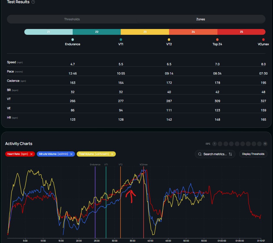

Funny the same thing happened yet again for an outdoor track threshold test on Friday. I’m going to try and recover the test itself. I’ve contacted support, wondering if it’s a cellular vs wifi thing. Anyone else do any outdoor testing recently and have the test crash on completion?
Ok well Tymewear did throw their algorith at it. One thing I found interesting, and from what I remember is where I marked it with the red arrow. That did feel like the point which I would consider a breakpoint. HR was quite low on test day, it’s always interesting to see how much further I can push myself on the bike, vs when mechanics of running break down for me.
