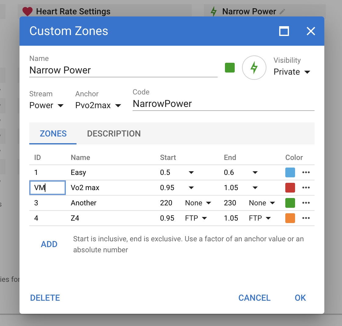

You should be able to do that with custom zones. This is still under development but the editor is live already:

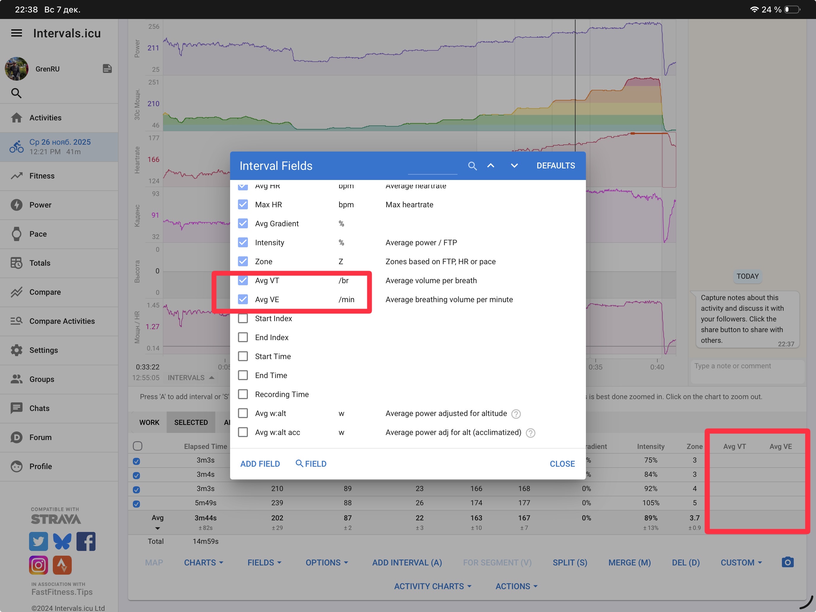

I’m new by Tymewear. Imported ramp test via .fit to inertvals.icu but didn’t see VT VE data in intervals table and chart
