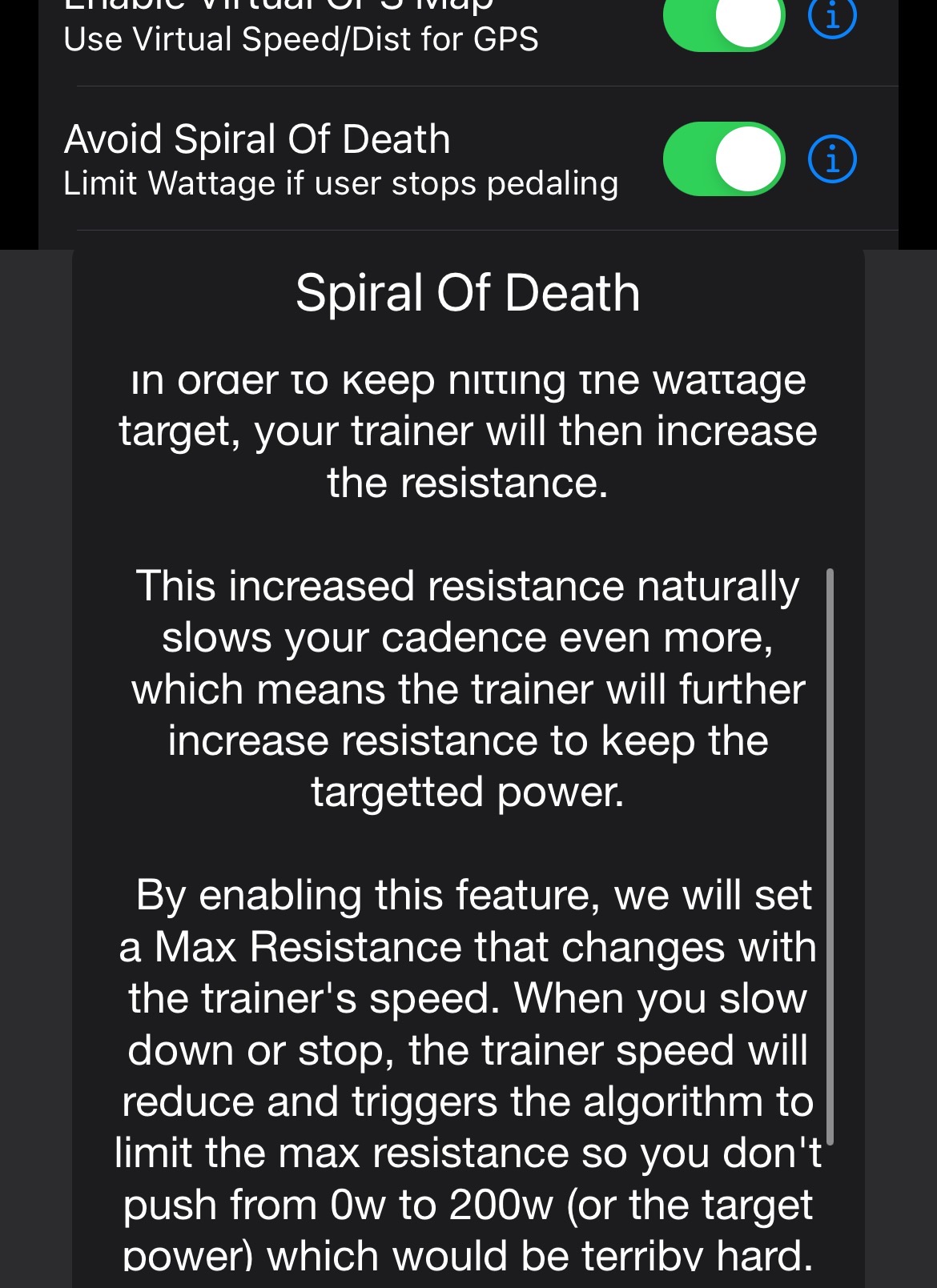

This sounds like possible ERG “Spiral of death” situation? since you’re saying at 50rpm. It like the trainer thinks you’re not putting in enough power, so it UP the resistance in an effort to get you to increase power, but in reality, you’re just spiraling cos the resistance is so high, you just end up not being able to pedal.
I’m not sure if this is the issue, but that’s something which I didn’t like in my own trainer, which is why I did this on my trainer App

I thought spiral of death was more when you drop below the target power and can’t fight it to get it back. Mine is just always high and then wears you out.
Second link is interesting as it seems someone has the exact same issue
I see. then it’s not likely that. Hope the links can get your sorted out.

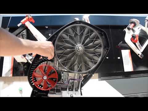

Doing this helped:
  • clean the stepping motor (yellow shaft) with a rag
  • grease again the stepping motor with vaseline grease
follow the first minute to see how to access
