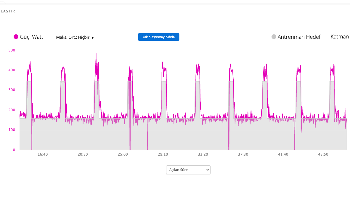

this is the my last training session, the power is always high… im so sad about this sitiuation target:343 avarage: 376! :frowning:
anyone has any idea?

Did you try the same workout, but using another device / app / software as a controller? It might be that the issue is in the communication between the edge and the Direto. Try Zwift+Direto and/or BreakAway+Direto and/or TrainerDay+Direto and see if there are differences in the behaviour of your Direto.
