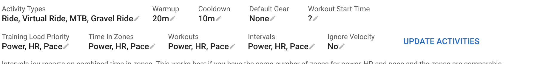

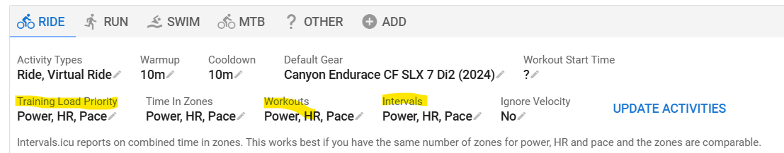

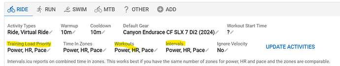

Did you check the Load priority settings?
If you have Power, set them all to have Power as priority.
Ok, Looks like it’s set to Power, HR, Pace
And I do have power for most of my current training rides.

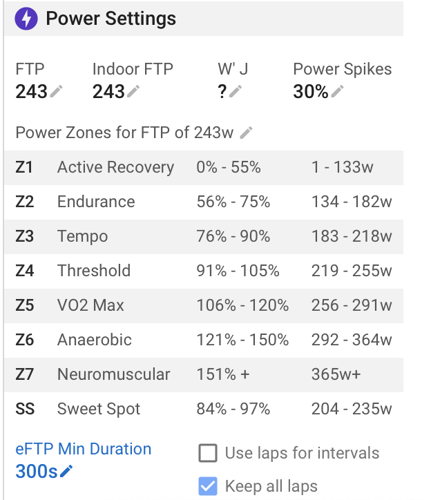

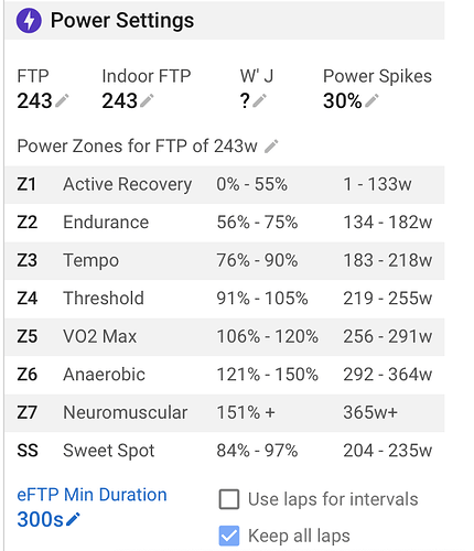

Same FTP/Zone settings? Indoor and outdoor?
Yep, same ftp for Indoor/Outdoor.
He means ´same on Intervals and on TP´!
Ah! good call. Checked. It wasn’t updated on training peaks. Was set much lower. Been a long time since I actively managed TP.
