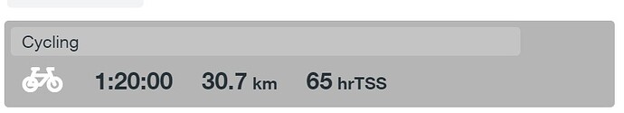

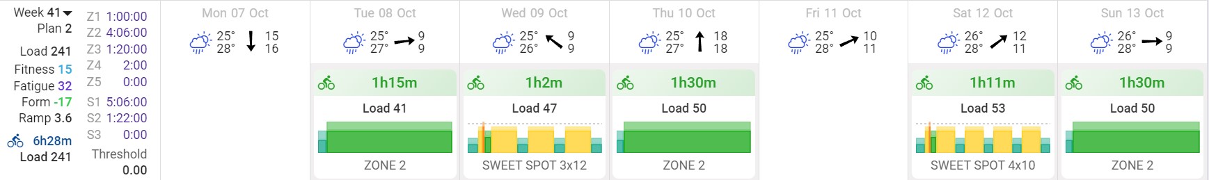

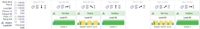

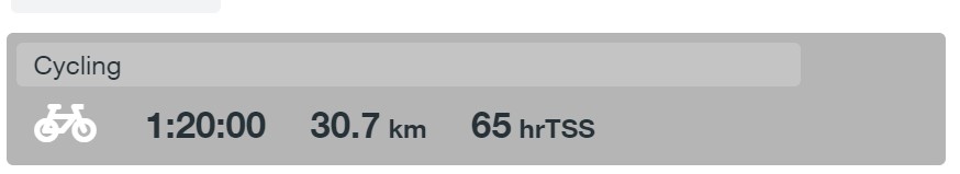

I am attaching screenshots of my training
This is from interval.icu
This from training peaks
TrainingPeaks number is hrTSS = HeartRate TSS. This is by no means standard, because there’s no standard way of calculating Load/TSS from HR. Even if your HR zones are setup exactly the same, the numbers will not correspond because soem calcuate based on HRmax, others based on LTHR and some on HRreserve.
You can only compare TSS from power and that should be very similar.
If you don’t have Power, that’s not a really big deal. The numbers may differ but the trend of the ATL/CTL/TSB will look the same. And that’s what is important, not the absolute number.

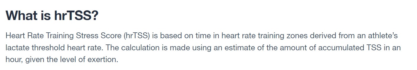

I just saw this above article on training peaks.
it says that the hrTSS is based on time in heart rate training zone. Derived from LTHR

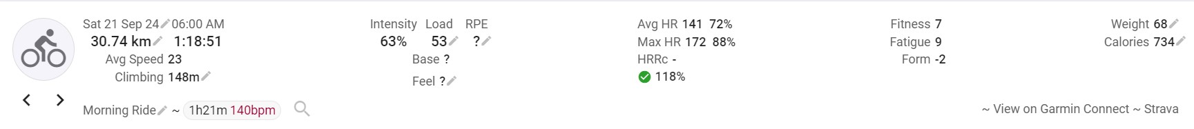

So should I set my load calculation based on time in zone or should I let it be to HRSS (normalized TRIMP)
HRSS is the most robust. So long as you have filled in your resting HR, max HR and LTHR it should give good results. If you often ride with power and HR then you can use the “time in zones” model for HR-only rides. This is specific to you based on your previous rides with power and HR and in my experience gives good results.
