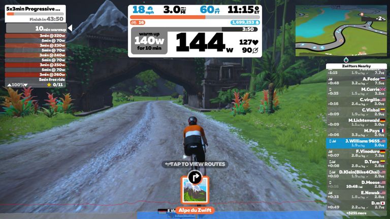

Let’s take this workout as an example :
sec = 1 x 60 x 60 + 11 x 60 + 25 = 4,285
NP = ?
IF = ? is this Wtd Avg Power / FTP? so 175 / 227 = 75%?
FTP = 227
3600
TSS = (4,285 x ? x 75%?)/(227 x 3600) x 100
72 (from my intervals site) = (3213.75 x NP) / (817200) x 100
0.72 = (3213.75 x NP) / (817200)
588384 = 3213.75 x NP
183 = NP
I’m still not sure what NP and IF are supposed to be - can someone help me out?
