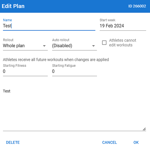

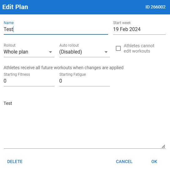

so I created a training plan and wanted to assign it to myself and hit apply. When I try that, I get the following Error:
“Plan has no workouts in the future for any of the athletes”
I don’t quite get what the Error indicates, the Plan is full of workouts?!

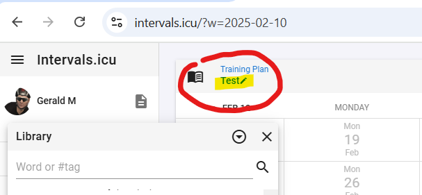

If you click on the pencil, top left, of the plan you will get the option to set a start date.
Set your date for the future, or in the past if you’ve already started.
I did all that. Mine’s set to start 24th of March, but the error persists.
EDIT: Just tried around, if I set the Rollout Plan to “Next Week” I get the error message I posted in the previous comment. If I set out to rollout the whole plan - it works.
