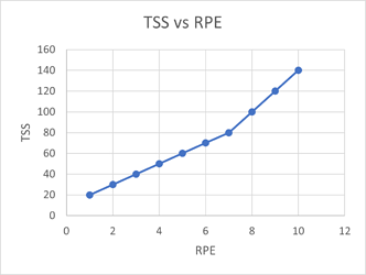

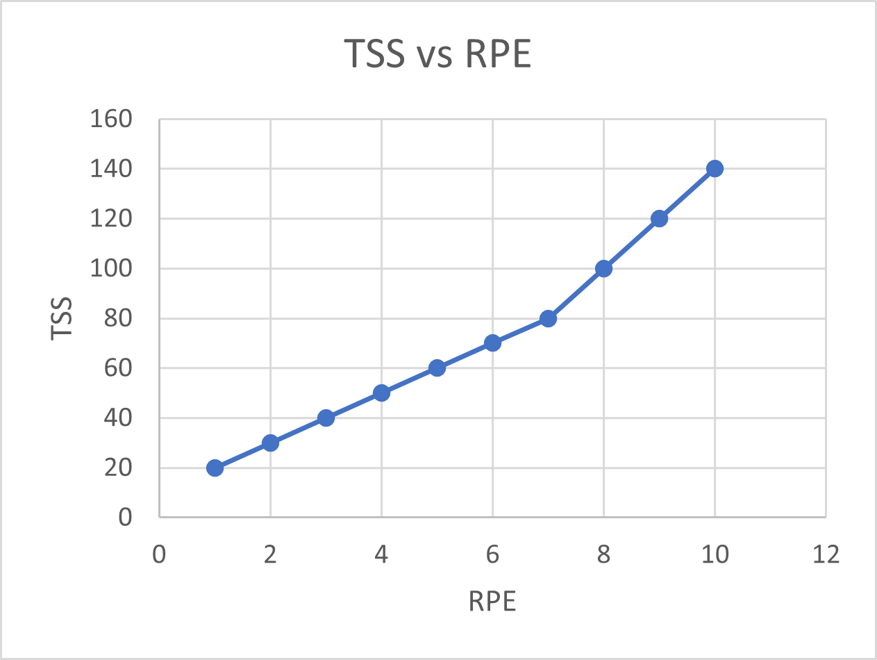

Thanks for the input guys! Your reasoning gives some perspective. I guess just using the TSS/TL value alone is making it too easy. And I agree with @nasatt that it’s rather an underestimation of VO2 max sessions than an overestimation of easier work. I mean, if you consider what happens physiologically when you pass FTP and transition into the VO2 max region, there is an obvious non-linearity (a “break in the curve”). This is not something you can predict by using the TSS power formula. It is approximately linear around FTP (and any other power). Quite interesting though is that the TSS vs RPE table suggested by TP shows a break:
The way I understand it is that TSS/TL can be a good measure/predictor between training blocks as long as the blocks have similar constitution of volume and intensity. And that changing both these parameters at the same time too much from one block to the next requires more than just a TSS value comparison.

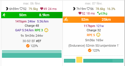

I’m not convinced. I am more tired after my indoor cycling than after my easy jog session, yet 48 TSS for running and 32 TSS for indoor cycling.
Run : 50’ easy jog
Bike : 10’ easy + 1’ @>110 rpm + 5’ @>80% + 1’ @>110 rpm + 6 x (1’ right leg + 1’ easy + 1’ left leg + 1’) + 10’ cool down
Training load priority for both activities: power, heart rate, and pace
Perhaps because the watts calculated by my Stryd sensor are not comparable to those of the HT sensor (???)
TSS does not consider work you have done previously. Without knowing more about what you have done before, there is a possibility your ride felt harder, because of the run the day before. However feelings on there own are unreliable. If you did, for instance, a massive ride in the morning, and a 30-min low intensity run in the afternoon, I expect the run will feel much harder than it the same run on fresh legs. The load is the same, its the accumulation of TSS that is creating load. Thats where metrics like form or TSB are relevant and the other one i use a lot is Acute/Chronic Load ratio.
I agree that the ride may have felt harder due to the run the day before.
I would not get bogged down in comparing run and ride loads though, as they are different. Stryd or no Stryd.
I think someone else said it above, TSS is a guide, there is lots it doesnt know. If you completed a session but were massively underfuelled and hanging on, it will give the same score as performing the ride well fuelled. The impact of finishing in a depleted state will have a knock on effect. Compound that by under fuelling recovery and the following day is going to get really emotional! TSS doesnt know that nor do any of the other metrics.
Loads can be very similar for cycling and running, on the condition that both disciplines have a fairly correct FTP. And that FTP can be really different in between running and cycling. For cycling in general it doesn’t matter what equipment you’re using, all real power meters give you something that is accurate enough in the same small range.
For running, on the contrary, power is the result of an algorithm. It’s not a direct power measurement. There are huge differences in between different devices, and no one can tell which one is the most correct. If you search on the forum, you will see that other users reported big differences in between Garmin wrist power and Stryd.
If your FTP for running is underestimated and from cycling overestimated, load for a seemingly equal stressing workout will be very different and so will feel.
