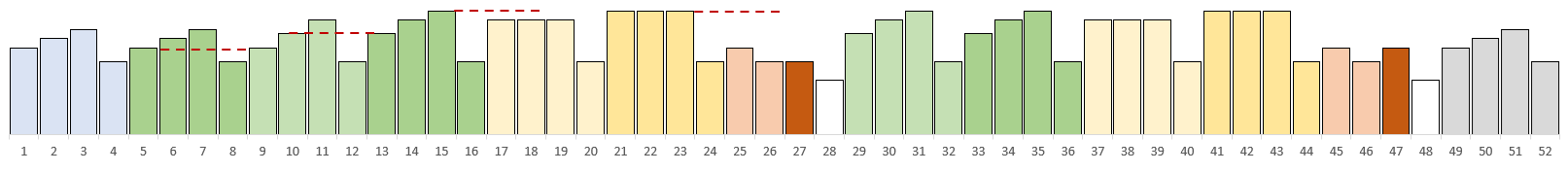

Here’s a generic periodised showing the progression each week, relative to each mesocycle:
This is for a 2-peak season.
Blue = Transition
Green = Base
Orange = Build
Red/Pink = Peak/Taper and Race
White = Rest
Grey = end of season.

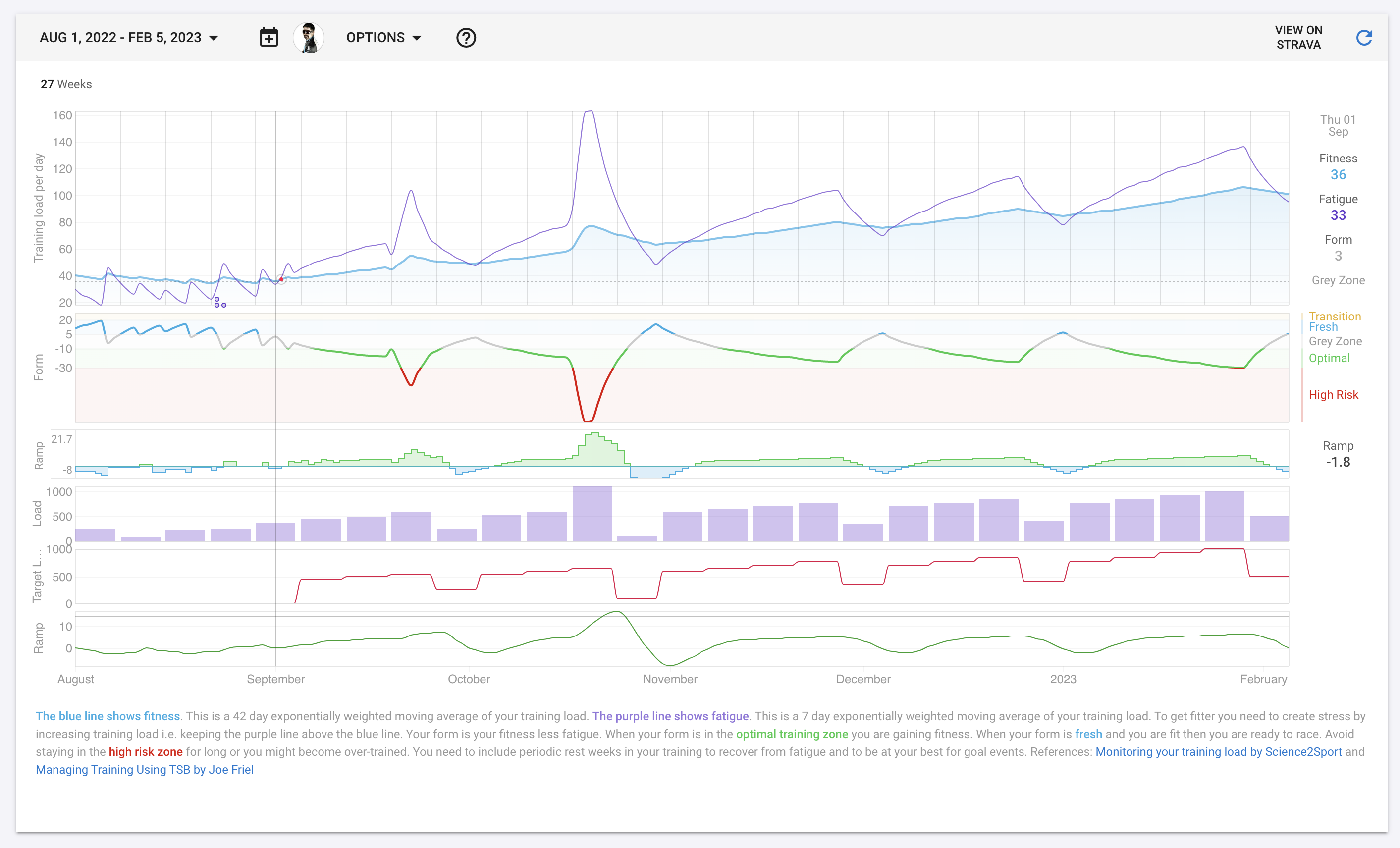

I am quite new to structured training but it worked really well for the British Transplant Games at the end of July where I won both the TT and Road Race for my Age group. I now have been invited to the World Transplant Games in Perth, Australia on April 15th 2023 so that is my main peak date!
I will do a fair bit of Zwift racing now over the winter where the rest of my training (up to 80% hopefully will be Zone 2). So basically polarised training! I have no other dates until then. I just want to build fitness and drop weight between now and then. When I get closer to April then I’ll switch to a more race structured training. I’ll be competing in 3 events, 10km iTT, 20km TTT and 30km Road Race!
I would think I am starting a new season now, with the end goal being 15th April. I have a middle weight goal that I will be racing top level Cat B low A by Christmas and kick on from there into the new year!
Thanks again for your comments, that makes really good sense!
Is this type of training sustainable? I’d figure I would just do polarised training until mid feb upping my load week on week with regular recovery weeks every 4. Then make it more Race structured Feb - April!
