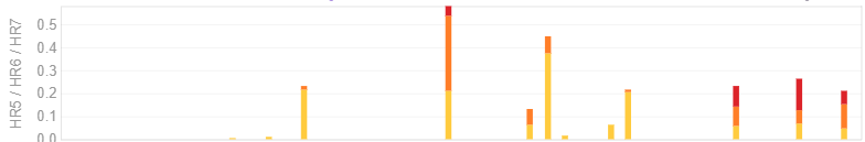

I made a chart that shows I think exactly what you’re looking for. It’s prev. day’s time in HR zones, colour coded and stacked, so just by looking at it, gives me a snapshot of “how hard that day was”, vs the prev. weeks, etc. Take a look, pic below. Chart is public, so you can just search and add it w one button click, see if you like it, delete if not!
Someone smarter than me could probably make it come up w a number, and somehow track this…TBH, that number probably already exists in the sys somewhere!! ![]()
Chart for searching is called HR TiZ PREV D, STACKED
I’m mostly looking at the size of the red bar: Like the 3rd from last bar was def a lot tougher ride than the last bar, even though they are same total, red zone is almost double. And 2nd to last ride was a monster. Needed an extra reco day after that beast.
