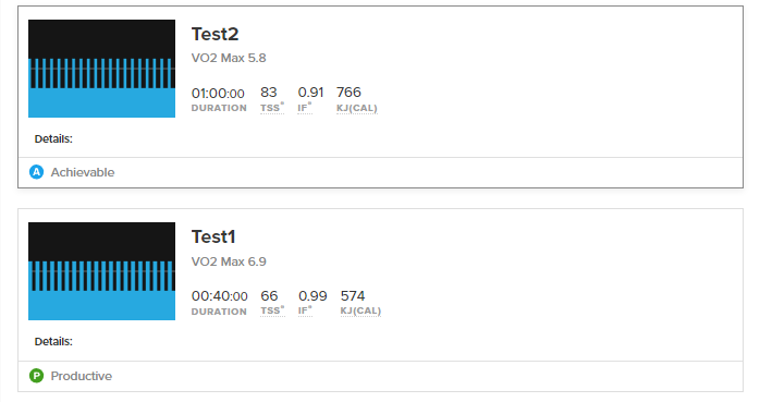

And to give you an idea what I mean that TSS is not a good measure. Compare these two workouts:
From a TSS point of view the first one seems a lot harder, even though the time with high load is exactly the same. Sure it’s longer but that is due to longer recoveries which won’t add a lot of strain. XSS in comparison is 87 for the first and 83 for the second, which is better than the 83/66 but still it has the first workout more difficult. When I put them into Trainerroad it comes up with the following
That seems a lot more to the point giving the one with the longer recoveries a much lower difficulty level.
