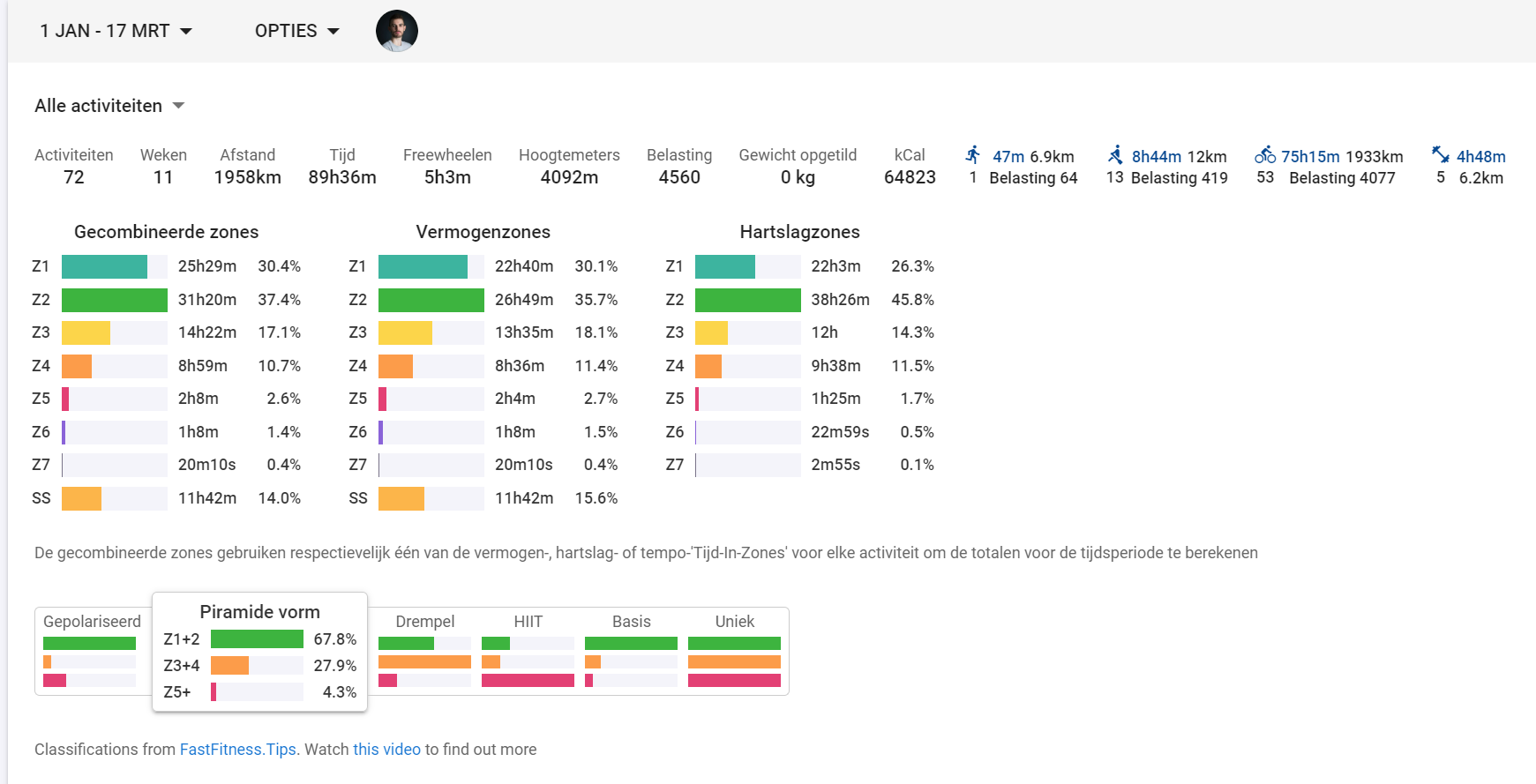

My doubts come from the fact that I’ve read polarised training is the way to go for the time I have to spare. Which I understand is: long steady Z2 rides combined some for example with VO2 max intervals (1 or 2 minutes intervals) efforts on the turbo trainer. However I’ve also read SweetSpot efforts are a good way to ramp up TSS, but this seems to contradict as Sweet Spot is high end Z3, which is the zone to skip when going polarised? When I look into my data and time spent in zones since January, I find that i’m in a ‘treshold’ approach which would be a less than ideal approach ? That distribition is partly because of some frequent sweet spot turbo sessions. So how does sweet spot training fit in a polarised training approach? (question 1)

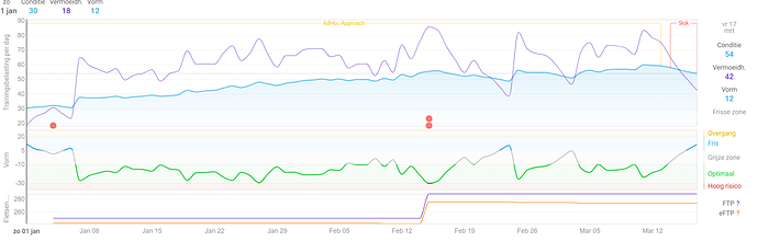

My progress since the start of the prepartion:
![image|690x220]

Is there like a ctl-amount that I should be aiming at? Or what number should be enough to be confident to start (and more important: finish). I’ve started out in January with a mere 30 and got it up to a 70. I didn’t do an FTP-test in 2 month so that number might be skewed upwards.
