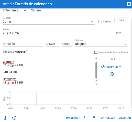

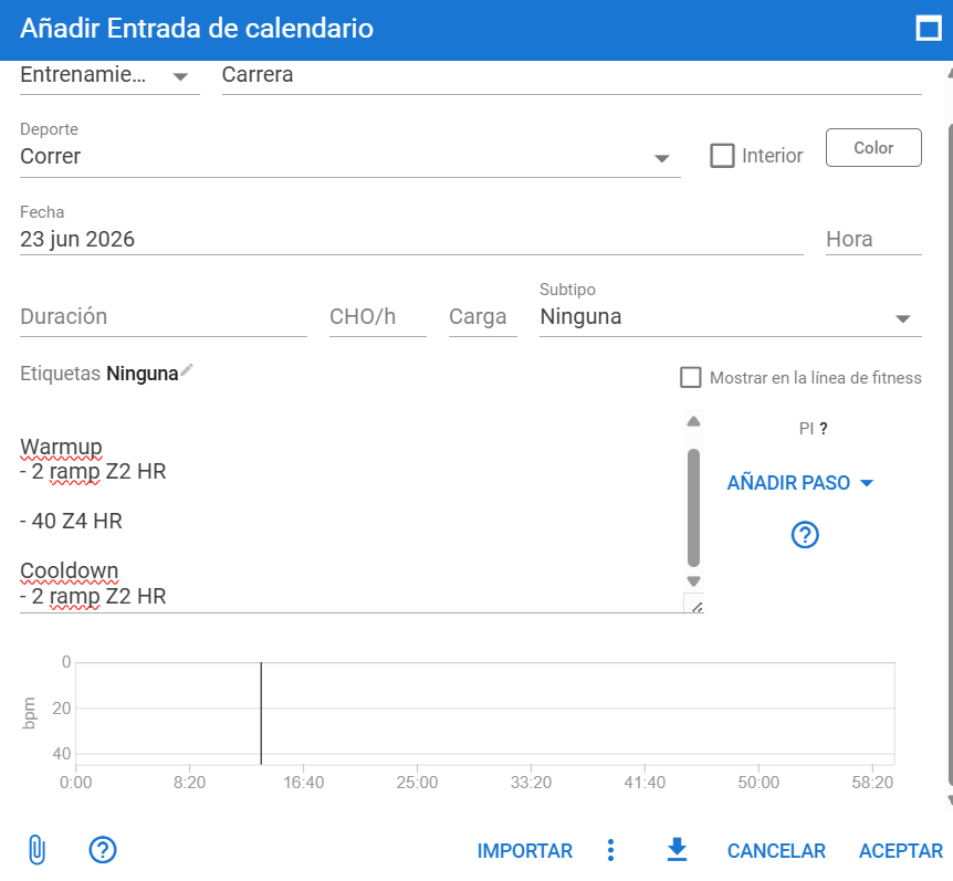

When I try to create trains it doesn’t work for me the graphic that is supossed to be created when I put the warmup in Z2 and main train in Z4, for example. Somebody knows how to fix it? I have seen in other sites that it has to be different, like in the second photo.

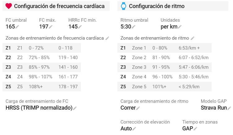

Did you setup your zones in the Settings page?
I think you didn’t…
Yeah, I have setup all the zones, HR and pace
I think because there are no units for your durations.
I.e. h, m etc for time, or km for distance
were they setup after the activity was added to intervals?
@Ben is correct, you need
2m ramp Z2 HR
40m Z4 HR
2m Z2 HR
