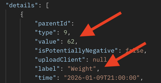

I’m currently developing an integration (tp2intervals) to sync data between TrainingPeaks and Intervals.icu. I’ve encountered an issue regarding Metrics (weight, sleep, HRV, etc.).
I have been following the TrainingPeaks Partner API documentation (API Endpoints · TrainingPeaks/PartnersAPI Wiki · GitHub), which does list some URLs for Metrics. However, these endpoints seem to be either outdated or non-functional in practice, as I’m unable to retrieve valid data from them.
Has anyone successfully implemented metrics synchronization recently? Does anyone know the correct or updated URLs to fetch health metrics from TrainingPeaks?
I’m trying to determine if I’m using the wrong endpoints or if there is a different set of requirements for accessing health data through their API.

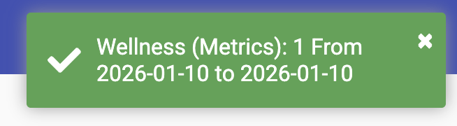

Remember that 1% chance? Well, I’ve got it working! :tada:
I managed to implement the weight metrics sync between TrainingPeaks and Intervals.icu.
Despite the general consensus that TP doesn’t allow metric writes/reads via standard API, I found a way through their internal consolidated metrics flow. It’s working perfectly in my dev environment.
I’ll be reaching out to the TP2Intervals maintainer to discuss merging this feature.
