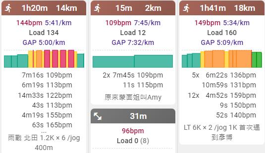

Hello,
The settings of max heart rate is 185 and threashold HR 165.
In the regular intensity training the load value is around 150.
For example, the left one in the screenshot is a 1.2K x 6 / jog 400m with load 134 and the right one is a 6K x 2/ jog 1K with load 160. Some simple heart rate data is also shown in the image.
training
This screenshot is an all-out 5K race with very high heart rate. However, the load value is only 53. That’s what I cannot understand. I believe the load is 150 or more.
Any advise is welcome,
Jones
