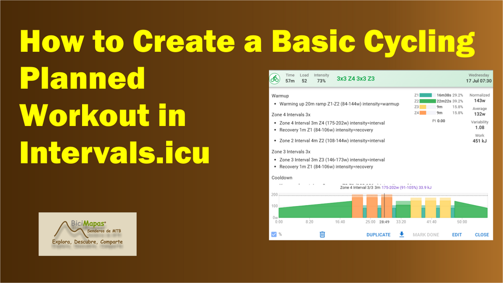

Hello,
I have two guidelines to create cycling planned training workouts that may help in what you are looking for (they are not free though):
