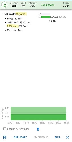

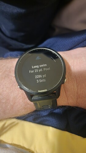

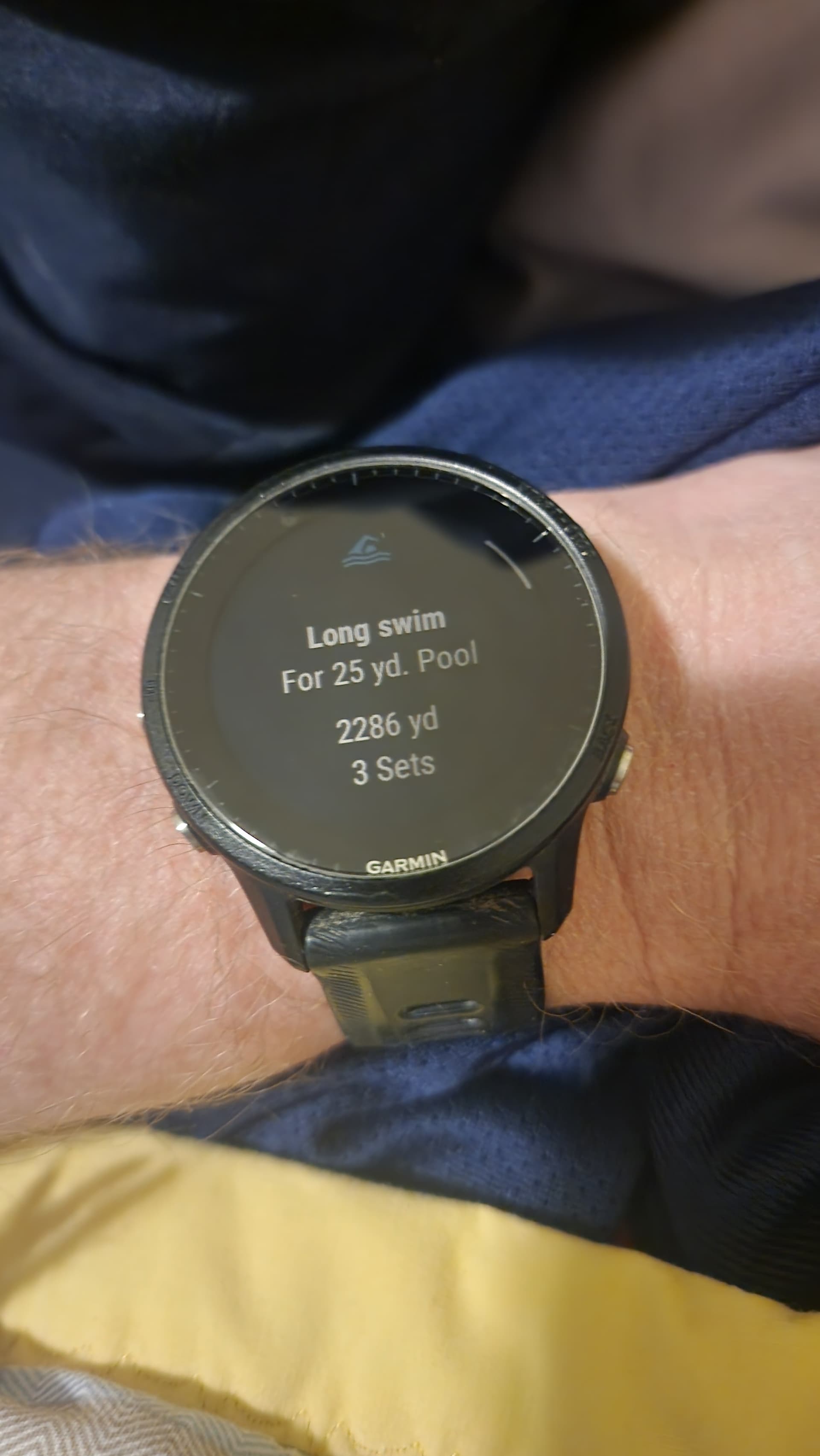

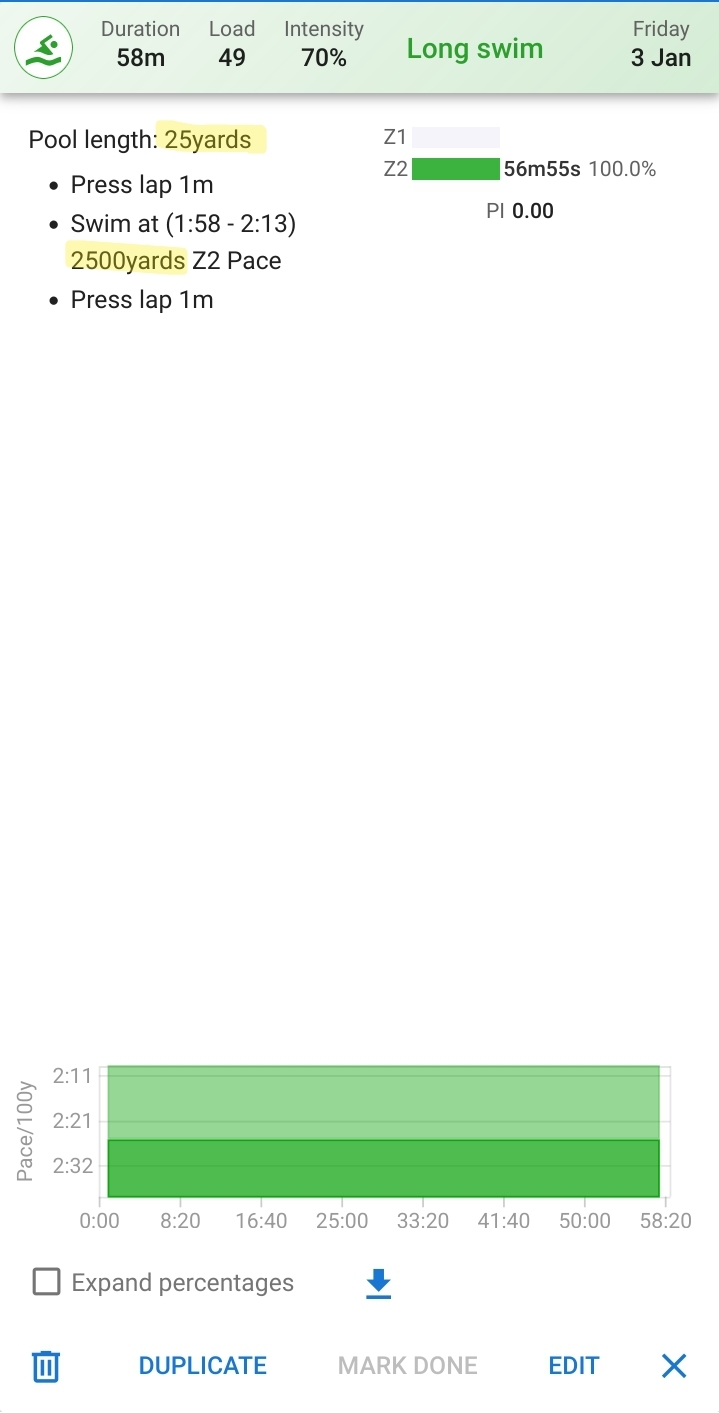

Not sure if this is an intervals thing or a garmin thing. My swim workouts are in yards. I set the pool length and enter the distance in yards. When downloaded onto the watch the workout screen shows distance remaining. Distance remaining is meters rather than yards even though it’s still counting down yards.
For example the workout today was 2500 yards (see attached) but the countdown screen showed 2286 yards (). 2500 yards = 2286 meters.

My workout files is:
pool length: 25y
Warmup
  • Warmup 200y Z2 Pace intensity=warmup
  • rest Press lap
  • Swim 50y Z2 Pace
  • rest Press lap
  • kick 50y
  • rest Press lap
  • pull 50y
  • rest Press lap
  • Swim 50y Z2 Pace
  • rest Press lap
Main Set 3x
-Swim 200y Z3 Pace
-rest 1m
Cooldown
  • 200y Z1 Pace
