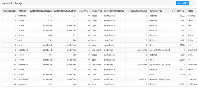

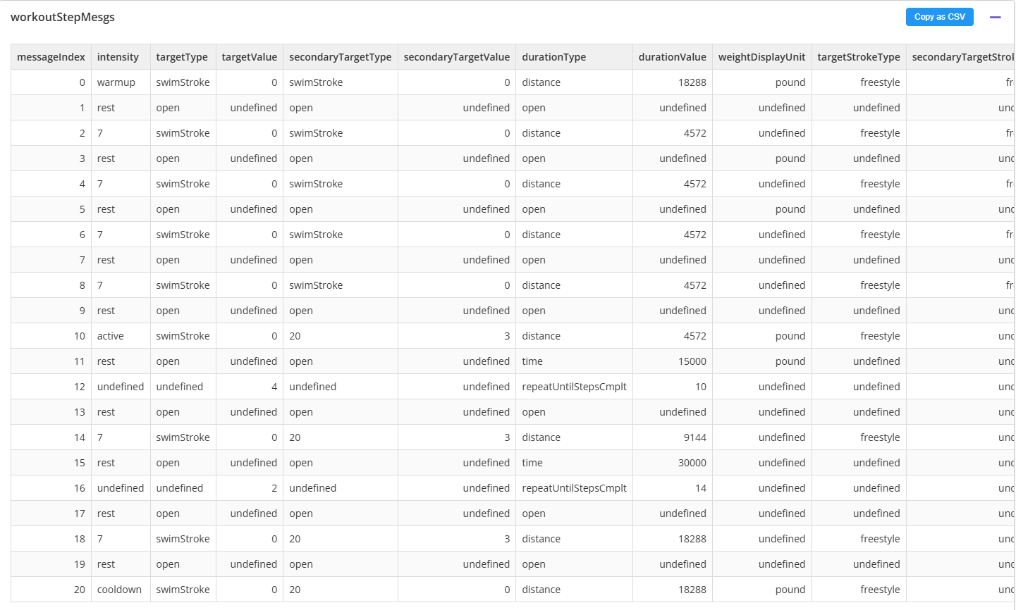

I think I give you the fit file Garmin generates, the fit file Intervals Generates, and the generator text if it helps?
I created the ‘same’ workout in Intervals and Garmin and downloaded the fit files.
The Intervals looks like this:
The Garmin looks like this:
Hope this helps. I do code a bit so if there’s a github I could make a branch for a yards/swim generator, let me know.
